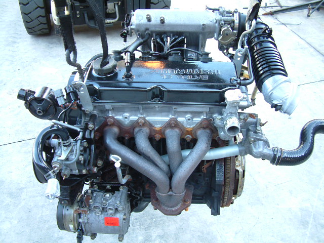

any one ever did or heard of a swap that works?
are parts easy to find in trinidad? does diamond stock parts for it?

i was told that the fto's motor is a direct bolt on to a ck..

It will line up easy .......the 1.8 4 is bolt for bolt, suspension is bolt for bolt. But your stance will change as the suspension footprint is different. The V6 is bolt for bolt except for the alternator needs a custom bracket and you will have 200hp.

hey guys i really was studying this conversion months now ,what would be a problem is the FTO transmission.
check the link above for all the info concerning the conversion and brakes upgrade

y will u guys go through all ah that for 200 hp and u can get ah 4g93t with d same hp even more with less work and cheap part and overall cost?????

1.8 gs fto engine...works exact in d ck lancer just wire up and drive,only modification is d axels for d fto engine is longer by 2mm(it will still work but when u turning corners u will hear a rubbing noise),so u have to use back d ck axels.
SCHOLARS is right 4g93t smaller and faster than v6............

but the 1.8 na dead and the 1.8t needs the fwd box..still more work
the v6 comes 2.0 and fwd and will fit. Iif you manage to fit a turbo in there..a weapon

yeah,dunno 2 much bout d v6 parts,but d 1.8 part are usually available by autorama's and P.T's
