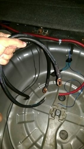

Prepping power cable for heatshrink, techflex and wire ferrule
Power cables to route
Wired to the distribution block one time

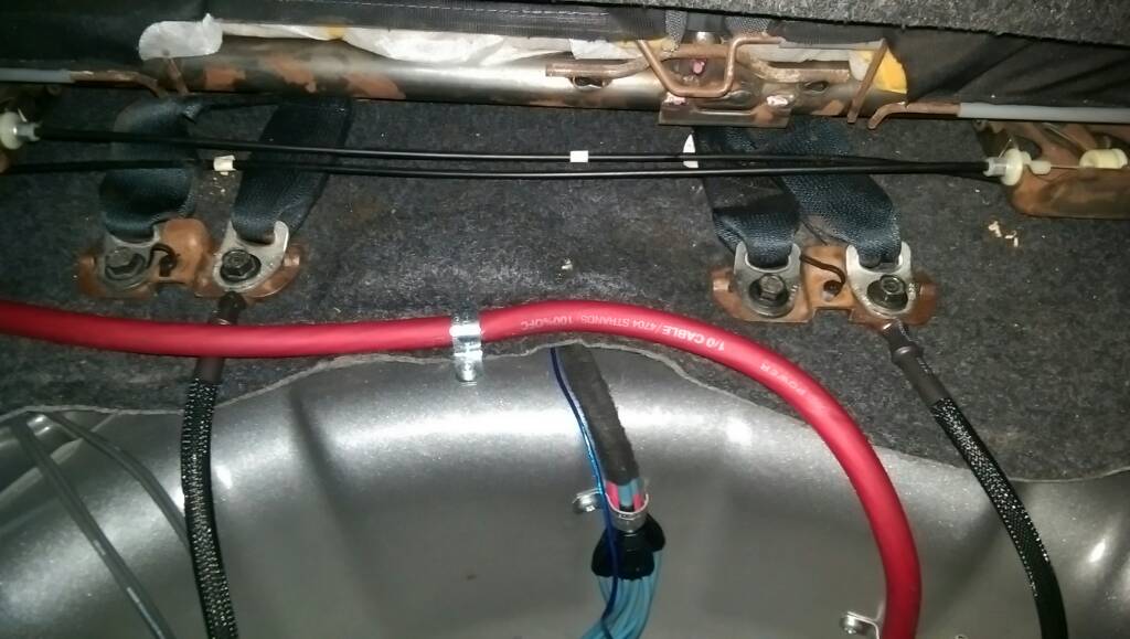

RCAs and power cable run completed
Both amps and the dsp fastened with square head screws
Under routing...power cable isolated from RCAs

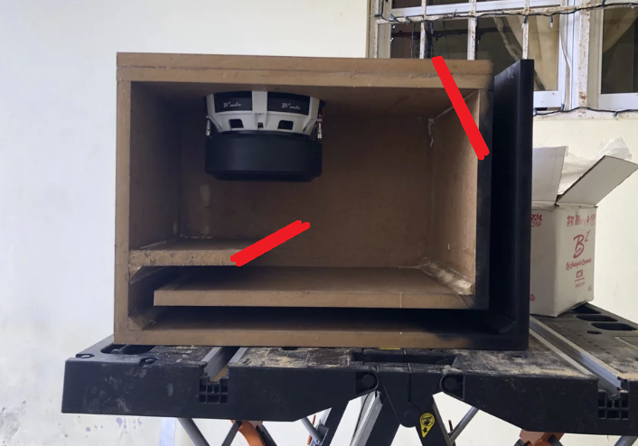

casper wrote:Image
Made some adjustments to the port of the box from this pic above being how it originally was
Below pics shows the process of the changes made
Knocked off the port piece that was going upwards to the back of the sub as shown before
Folded the port 180 degrees and sketched where I wanted to place some 45s to help improve airflow
Making the 45s
45s added at the 4 corners sketched before
Reason for adjusting port placement is that I felt the port placement before was too close to the back of the sub so wasn’t sure if it would’ve affected air flow and compression...maybe it might not have been an issue but just wanted to make sure
SR
Chief Cook & Instigator
Posts: 13958
Re: Small everyday system
Postby SR » September 13th, 2018, 4:57 pm
Round off the edges of the board exposed in the port itself to match the flow created by the 45degree inserts in the port
Brian Steele
Posts: 877
Joined: December 3rd, 2009, 5:37 pm
Postby Brian Steele » September 13th, 2018, 6:36 pm
SR wrote:Round off the edges of the board exposed in the port itself to match the flow created by the 45degree inserts in the port
It's a resonant system - air won't (or shouldn't) be flowing through the vent, but vibrating inside of it. As such the 45 degree chamfers in the vent are not required and actually act to raise the resonance frequency slightly because they reduce the mass of air in the vent.
However, having said that, the entrance and exit to the vent (particularly the latter) represent "discontinuities" and should be treated a bit (e.g. rounded off) to reduce possible turbulence. Even better would be to flare them as indicated in the attached image. The wider and deeper the flare the better. Hornresp can be used to model the resulting Fb when using a flared vent like that.

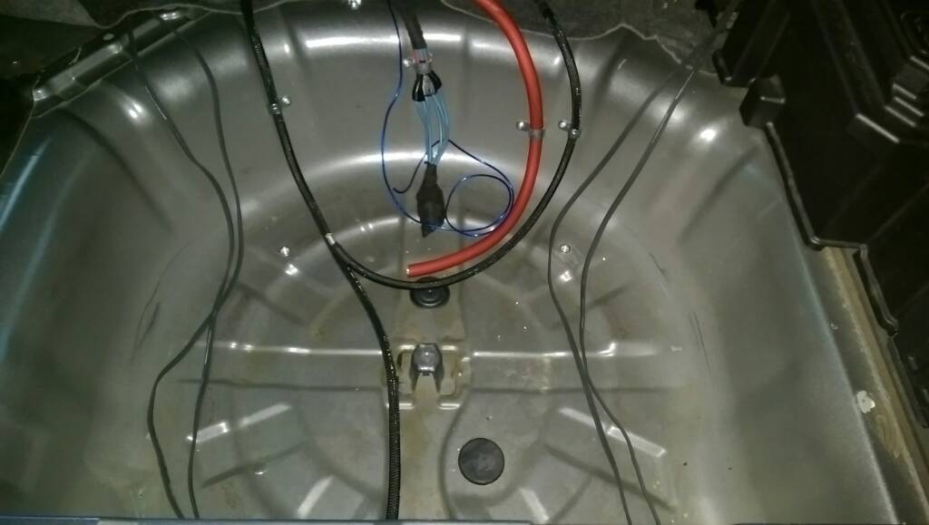

Taking forever to finish this cuz of lack of time but here's where I reached..ran wires to the well...
Need to scrap back out doors to figure out which speaker wire is for which speaker tho ...that's what have me in procrastinating mode atm...sighz
Tested out the sub in a bredren's vehicle just to hear the tone...playing real nice and full on small power from his 4 channel amp...looking forward to hear it on mine...
Still need to install door speakers...tag the speaker wires ...install the ferrules on them...and do the other false floor above the amp rack to fit the spare tyre...

Postby casper » September 26th, 2018, 11:55 am
Really like the edits u made with the box ...thinking to make another cuz when u sent this I already finished it and carpeted
