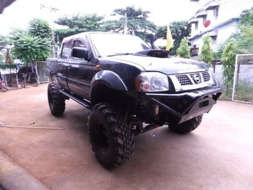

There is a black BT that looks real high...anyone know him ?

^^this??

Harry from Trailblazers....3" body lift and tyres....that's all...!

yup 3" body lift and 33" tires, everything else stock.....
Harry does this 3" body lift for and average of $3000, drop the vehicle and collect back with everything in order, jus pay, drive, and smlie

^ Thats the dam thing self ! - Someone PM me the number nah - I really like this look.
How does he do it though ? Safe ?

Hadda be safe after seeing how him and gopaul drive them offroad..
