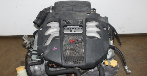

Media Graphics Ltd. wrote:Eaton m62 supercharger in hand. Time to add boost to my lifted na forester.
Just a small update. Didnt get to install it yet but came up on a deal for a better setup that i just couldn't pass up. Supercharger project is on hold indefinitely, might put it in a ts or something or sell.
This is the new setup.
I should have it in and wired up in no more than 2weeks, but it might be a month or so before i have the free time. I guess it wont be an ej anymore at this point, so ill have to make a new thread.

Re: The Tuning Thread- EJ Motor
Postby Ted_v2 » September 12th, 2017, 1:46 pm
Daz a 3.0 flat six like from mcm build? If so it's a nice option. It's electronic Trottle not so? How u coping with that

Postby infinite_RPM » September 12th, 2017, 2:06 pm
I think it's a ez30... And I also believe mcm used a 3.6 Tribeca engine
TheBoostLord
Posts: 989
Postby TheBoostLord » September 12th, 2017, 3:24 pm
ez30d, not ez30r or ez36r. The d is cable throttle and worlds easier to wire up.
