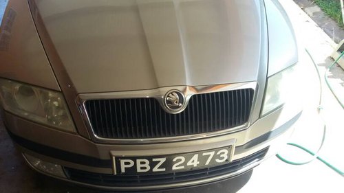

Having a hard start issue when engine hot. Whwn cold its starts normal but misfires a bit. Gas economy is horrible at 16 until after a good hard run it goes to 9.
Btw new headlamps tomorrow. Pics of install tomorrow. Visteon brand made in czech rep.

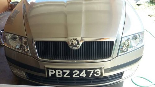

Replaced headlamps today.

Postby Team Loco » August 6th, 2016, 3:06 pm
Now the damn fogs look old. Lol
Headlamps are made in czech made. Costed tt$1900 /pair landed. No mods. Plug and play. Brand is visteon. Next up are rear shocks to replace
