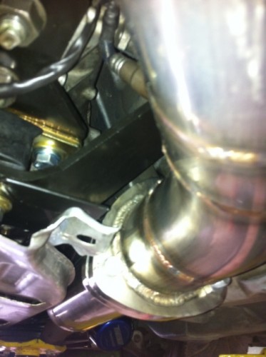

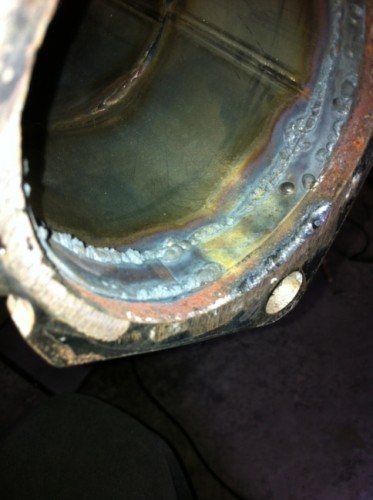

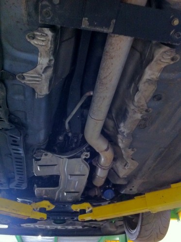

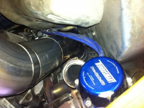

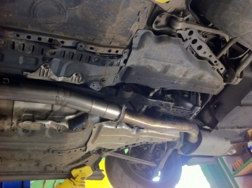

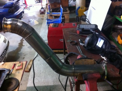

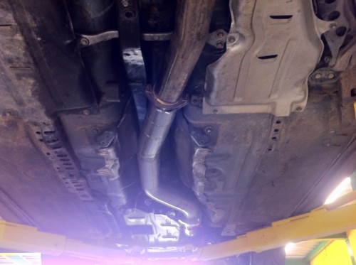

a stainless steel 3.5" exhaust i made...sorry for the phone pics :| ...just a hobbyist 8-)

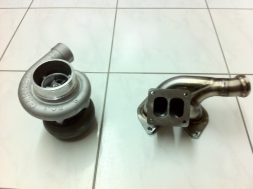

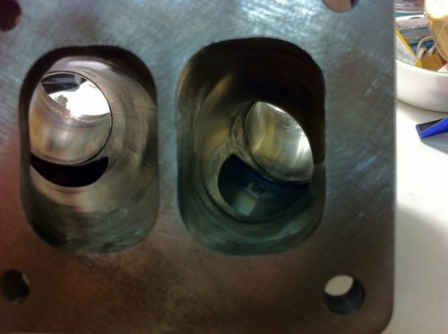

This is the original 3" exhaust done by Specialist Muffler in galvanised mild steel...

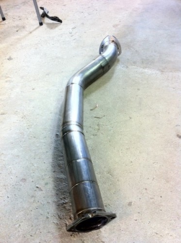

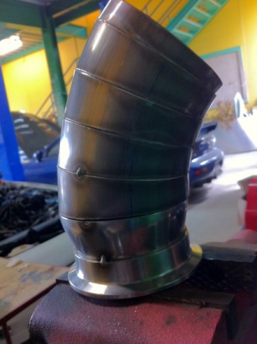

I had bought mandrel bends but the radius of the bends were too large and wasnt clearing the firewall..so i had to make a pie-cut bend...calculated the angle to cut the tubing to make a 4" radius bend...
The downpipe had a couple things to clear as well...the wastegate and the transmission crossmember

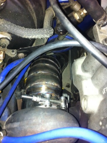

midpipe tacked up
downpipe tacked up

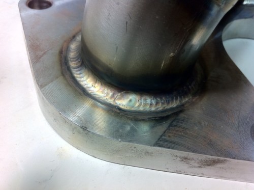

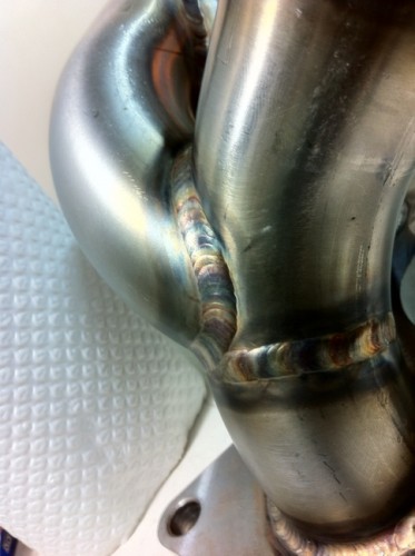

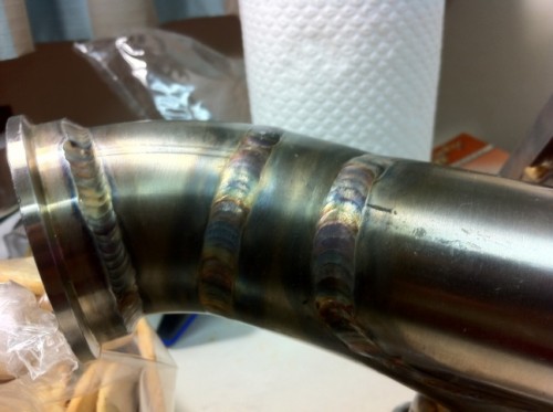

This is what happens to stainless tubing if you dont purge the inside with shielding gas...When it is purged it looks like the weld that you see further inside of the tube...flat and clean...i could not weld the flange joints with the purge gas because the duct tape used to cover the ends was melting with the heat...but being on the ends it is easy to grind flat.....

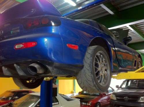

thanks!....i have a couple pics that i took...the catback is the RE-Amemiya catback...

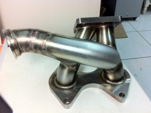

Very very nice MG Man and ImmamurA

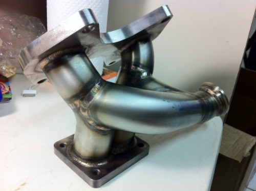

I've been waiting a couple months on my Toxicfab v3 stock replacement manifold for the 4G63 in the evo. Collin@Toxicfab does immaculate work. He recently moved his shop so he's a little behind on customer orders but it's worth the wait:
A vid of him working

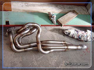

I want some high rise headers for the 22R-1 in Chelsea.
Need to do it in SS one time so that I wont have to replace after a year or two.
This will be a custom build so I will guess major price will be called.
We will see...

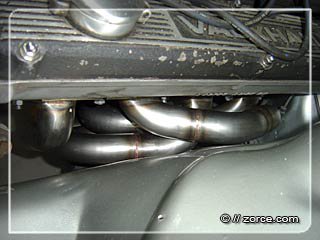

Something like this:
