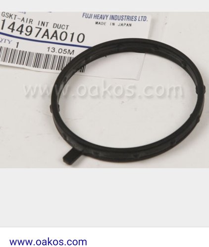

Looking for this. Checked all popular Subaru dealers, even Massy. Assistance appreciated. seal
Sent from my C6603 using Tapatalk
Posts: 23834
Re: LEGACY GROUP TRINIDAD; THE PLACE WHERE WE MEET ;-)
Postby nervewrecker » December 5th, 2015, 5:52 am
What seal is that?
Tried motorist?
Sent from my Nexus 4 using Tapatalk
racedriverpro
Posts: 3266
Postby racedriverpro » December 5th, 2015, 6:32 am
That goes between the turbo and elbow to intercooler. It's common for them to go bad.

Postby Lance » December 5th, 2015, 8:19 am
Do you suspect it has gone bad?
racedriverpro
Posts: 3266
Postby racedriverpro » December 5th, 2015, 3:36 pm
Its worse than gone bad, it gone completely and high temp silicone used to seal...but not too well. Made this one using oil filter seal. Will see how it goes. I believe that this may be better than the original due to it being thicker and designed to take high temps. It was taken from a used filter btw. Will still like to get original just in case.

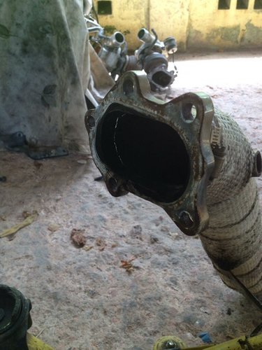

Postby racedriverpro » December 29th, 2015, 12:30 pm
Anyone experiences exhaust scent at wot or high speeds without ac?
Posts: 23834
Postby nervewrecker » December 29th, 2015, 10:09 pm
When you say exhaust scent?
Sent from my ONE E1005 using Tapatalk
castortroy
Posts: 85
Joined: April 26th, 2014, 1:56 pm
Postby castortroy » December 30th, 2015, 12:21 am
Check out d downpipe gasket or d welds on d downpipe flange itself, was smelling d same ting and lo and behold....
racedriverpro
Posts: 3266
Postby racedriverpro » December 30th, 2015, 9:02 am
Thanks castortroy...

Racedriverpro, are your afr's going up on idle?
racedriverpro
Posts: 3266
Postby racedriverpro » December 30th, 2015, 11:15 pm
I wudnt say that the afr was going up. But the scent I was getting is that of black exhaust smoke at high speed or during/after wot.
Had the gaskets for up and downpipes replaced with steel gaskets today so il be monitoring over the next few days. Wish I cud just change entire exhaust.
castortroy
Posts: 85
Postby castortroy » December 31st, 2015, 8:45 pm
The grimmspeed gaskets actually works pretty well also
