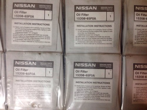

what is the oem nissan oil filter number for the sr20ve? thinking about buying a few online but i am getting conflicting part numbers.

Postby ruff neck chicken » February 18th, 2014, 9:24 pm
i asked because a tuner told me this is what he uses from gspec.
and when searched the forum here i found
15208-65F0C
15208-65F01
15208-65F0A
does the last number/letter create a difference?
i am looking to purchase a set online, any recommendations?

Those are "hecho en Mexico".
