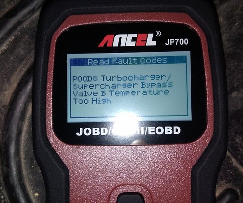

Good day. I got this code: P00D8 in my 2012 4x4 hilux with a 2kd engine. The turbo is louder than usual and is making a siren sound. Does this code mean that the turbo may need repairing? Thanks
