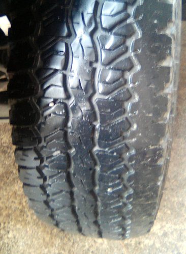

This is the front left side. If you see the outer edge almost smooth compare to the rest of tyre. The right side tyre is not this bad but still uneven in terms of outer edges lower than inner. Currently running 32psi cool

That look like a camber problem b. Firestone destination at. Toe in dont really look like that. What size though? Im sure it Must make noise when u corner with a couple persons in van.

265 70 16 on stock rims. The torsion bar cranked a bit but even to stop rubbing. So the Glen guy has the equipment and knowledge to fix this? How far in from Mon repos gas station

rmrunner wrote:265 70 16 on stock rims. The torsion bar cranked a bit but even to stop rubbing. So the Glen guy has the equipment and knowledge to fix this? How far in from Mon repos gas station
Walking distance. Its about 6 or 7 buildings from gas station heading east.
But you need to ensure distance is the same from fender trim to center of rim on both sides. Then when you go tell them camber with shims, dont adjust torsion bar. But you should put the back tyres in front if they better (more evenly worn)

Nah bro. I did that before and I took a corner on a wet road and the back start to drift me off the road. Will change the two front for now if anything. A full set in due time.

From this it looks like toe but when I go to align will see what's off

rmrunner wrote:From this it looks like toe but when I go to align will see what's off
Well from this it looks like toe wear, same u indicated before. Had the same wear on a pickup and it turned out to be camber. So i guess when its on the machine you'll know

kamakazi wrote:@Joshie23
If I understand what you are saying... You went by Mack they told you to fix one problem instead of identifying everything wrong with your suspension.
That's basically it, and then when I replace the cradle bushings, come back for them to then 'continue' the diagnosis.
My left front tire is cutting the same way, looking like toe wear, when it's actually a camber issue, from what my suspension tech told me. Apparently the previous owner replaced the camber bolt with an inferior one. So from my little knowledge, there's that bolt and a missing flange bolt to replace, two big cradle bushings and I'm hearing a CV joint making some noise. Align and then I'll be looking for two tires for the front as the back ones are still in excellent condition.
