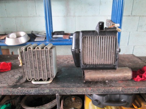

anyone ever tried modifying the evaporator like using a b15 evaporator or such and adapting it to fit in the original b11 evaporator box???...reason i'm thinking of trying this is due to the amount of heat transfer fins/surface area those new type evaporator has, it will increase the efficiency of the cooling effect of the air passing through the evaporator...

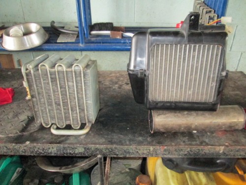

Postby d_sunnyboi » June 10th, 2013, 1:42 pm
just discovered that the local and foreign evaporator is different, the local evaporator has 7 rows but the foreign has 15 rows which means that the foreign has 2x the surface area than the local which mean that efficiency will be better for heat transfer...also to add to this i am lookinf for the foreign evaporator to buy!!!...asap

black start
Posts: 7974
Re: *OFFICIAL NISSAN B11 CLUB*
Postby black start » June 10th, 2013, 1:47 pm
In the foreign, is the expansion valve built inside the housing like the b13/b14 evaporators?
I also want to buy a b11 foreign evaporator, so if you know anywhere that has, link a fellow b11 tuner nuh...
Postby d_sunnyboi » June 10th, 2013, 1:55 pm
yes the expansion valve is on the inside of the housing...
d_sunnyboi
Posts: 299
Joined: April 30th, 2010, 8:13 pm
Location: trinituner.com
Postby d_sunnyboi » June 10th, 2013, 1:58 pm
but the housing of the local cannot work with the foreign unless you cut the housing on the bottom,sides and top for the evaporator itself to fit
black start
Posts: 7974
Postby black start » June 10th, 2013, 2:03 pm
oh, I didn't know this. So I guess I'll be looking for a local evaporator housing and trying to fit a newer model evaporator in there then....
I wonder where I can get just a bare housing to buy.....hmmmm....

thats what going on with me...lmao...steady have to be wiping glass...so i went and got it organise but it not cutting it in the hot weather so i looking at ways to improve the system, i used a y11 condenser and that working tops...the gas leaving cool enough where you could hold the line itself and just be warm...but the problem is the gas leaving the evaporator without being totally efficiently absorbed, so doubling the surface area will solve that problem.now also noticed fittings are different on the foreign evaporator...sooo..
