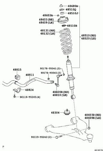

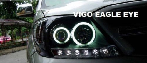

On another note... Has anyone ever went for inspection with LED park light bulbs...I want to know if I will have any trouble with them because of the white colour. It is the first generation of the bulb linked below.

Postby ADONI » April 13th, 2018, 1:34 pm
I inspected twice already with these lights, if this helps.
Wah rubbers allyuh talking about? The rubber in the rear shock?
hilux lights.jpg (21.88 KiB) Viewed 6782 times
The front shock absorber... Lower rubber.
The headlights are OEM running a standard h4 bulb... Is just the park light bulb is an LED bulb

kamakazi wrote:
ADONI wrote:I inspected twice already with these lights, if this helps.
The rubber in d 'eye' of the shock? If so, I am only seeing a PN for the back and not the front. Some reason, I can't upload a drawing of it.
