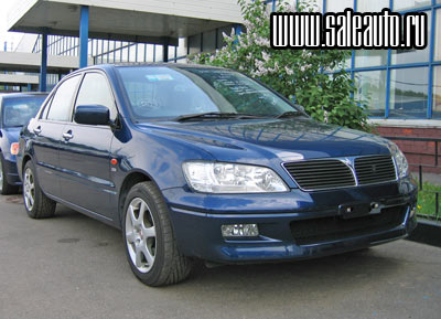

Postby Jade_Inc. » December 25th, 2014, 7:25 pm
Looking for fogs like that guys, anyone can help me out?
if u know the model number for the fogs leme know plz. thanks

Postby QG » December 25th, 2014, 8:58 pm
Fogs look good

Postby ZeroOne » December 25th, 2014, 9:03 pm
I have the rectangular fogs, one is kinda cracked at the back but usable...PM me if interested.
