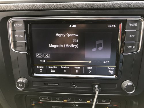

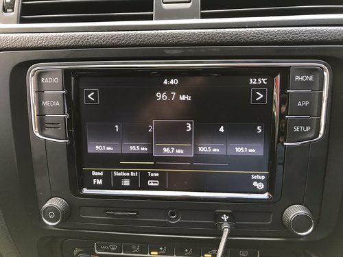

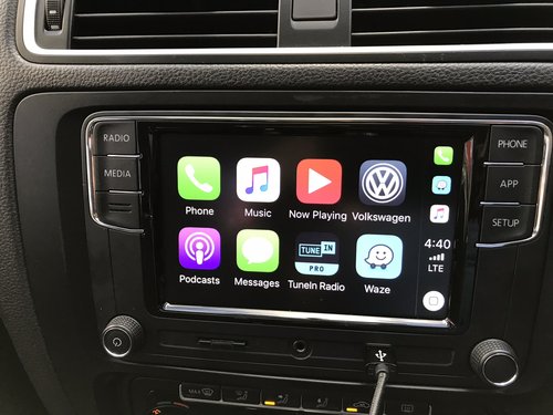

Replaced OEM RCD 510 head unit with RCD 330 plus. Lost some MFD integration and ability to play CDs but now have Apple Car Play and Android Auto. Straight swap plug and play with an adapter for the FM Antenna. Will post pics in a bit

Pros and Cons of new 1.4 tsi Jetta
Postby greggle71 » November 4th, 2018, 4:43 pm
A few pics
The attachment IMG_0354.JPG is no longer available
The attachment IMG_0355.JPG is no longer available

When pressing recirculation mode button etc..does it still come on screen?

aaron17 wrote:When pressing recirculation mode button etc..does it still come on screen?
Lost that as well but considered minor IMO
The voice command on the steering activates SIRI instead of the stock function voice command

Postby Allergic2BunnyEars » November 4th, 2018, 7:13 pm
That’s cool. Nice fitment. How much did that cost if you don’t mind me asking?

Postby aaron17 » November 4th, 2018, 8:24 pm
Does it have the clock on a black screen? Love that feature when idle rather than that constant bright screen.

aaron17 wrote:Does it have the clock on a black screen? Love that feature when idle rather than that constant bright screen.
Yup, well just to clarify when you press the power down it defaults to the clock. Looks great
