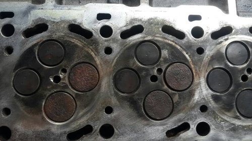

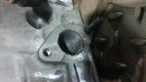

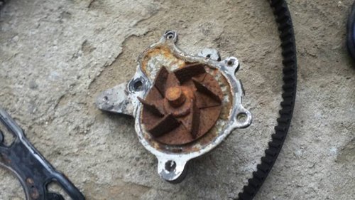

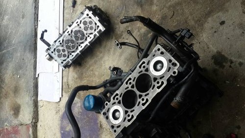

Just removed my engine after overheating and water pelting out bottle. Saw a water jacket leaking, I figure that was a cause of the gasket failure.
Also I always had whitish diesel smelling smoke from exhaust, could that been gasket failing symptoms? Also I fine for a turbo diesel it was a bit slow, and catch ass to cross 120km/h. Turbo intake part is dry and clean, the outlet to cooler piping has oil, and like 2 caps of oil sitting on the throttle area when hose removed.
Anyone know where I can get parts? Will need headgasket, glowplugs, valve seals, timing belt, waterpump, piston rings and if I can get a used good turbo for a good price.
Might as well rebuild just incase as engine is out.
I cleaned the EGR last month, and the canister was clogged also, which triggered off EGR Insuffient flow check light but that stopped since I cleaned it.

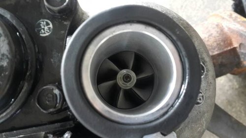

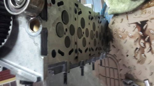

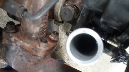

Turns out my turbo is good. I took off the outlet pipe and it was dry. Possibility the the gasket failed between cylinders 2 and 3 as brown rusty valves can be seen.
So head is now going to machine shop to check snd well i gonna need the glow plugs, water pump, head gasket and timing belt as i dont think the valve seals were bad. Would like to change it but my valve spring tool was stolen and its pricey

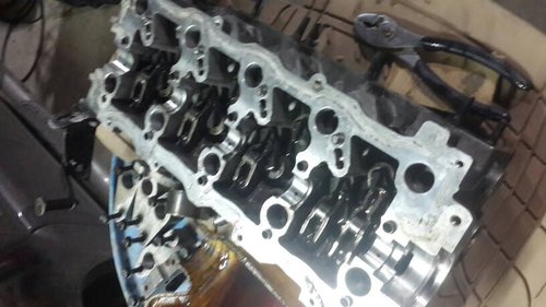

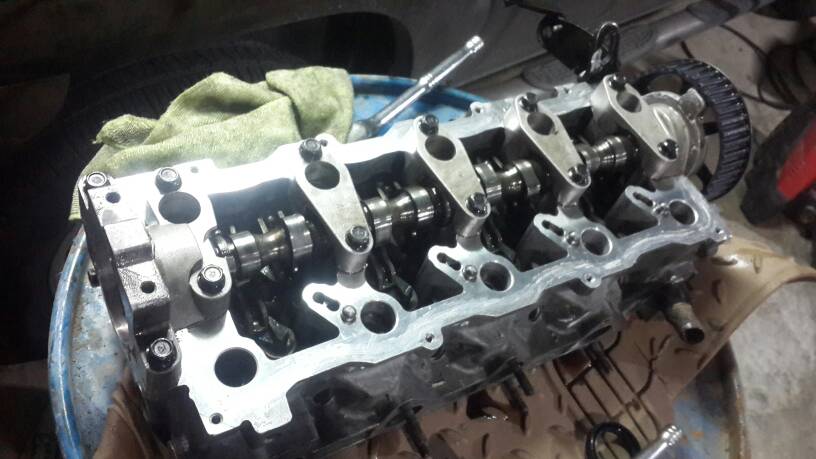

Did some polishing in the head exhaust ports

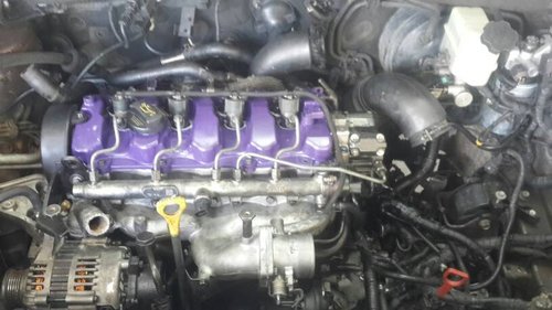

Engine mounted up last night, new gaskets, new parts etc....Should be driving today if time goes correct :D

Since then i eh do nothing til this morning. Now installed and bolted up top snd bottom bolts to close engine and trans and also bolted all 4 mounts. Was a bit rough with just me alone lol but is just to plug on stuff and start. Hadda head town now so by this evening i should start
