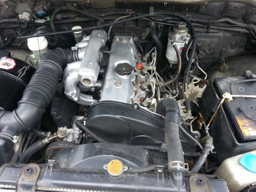

I have to do this ASAP, gears going in hard. Changing engine and g/box oil this week.
Engine bay needed a wash so Sunday I used breeze/kerosene mix and a pressure washer to get it back to specs!!
L200 engine bay

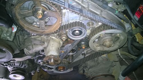

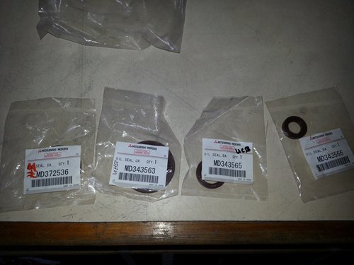

All front seals (Cam, crank, balance shaft)
Timing belt + Balance shaft belt, Tensioner pulleys (2)

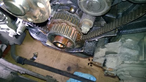

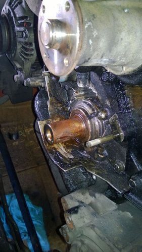

I would recommend this mechanic to anyone since he is well certified and professional. The only problem he had was the gear on the crank snout got seized up. You can see how rusty it is in the pics. I am happy overall with the job done, the time it took and the cost. The next big service to be done is the clutch but its holding out so I am just gathering the parts piece by piece so its easy on my pocket. Now on to the pics....
All front seals in genuine
Belts and tensioner pulley
Dirty and seized up
Crank snout with gear removed
Re-assembled and clean

VEry nice man! where'd you get the genuine seals to buy?? and how much u paid? if u dont mind?

yeah man thanks, the mechanic had the small one for balance shaft $75, and the others bought at various parts outlets $100-$145.

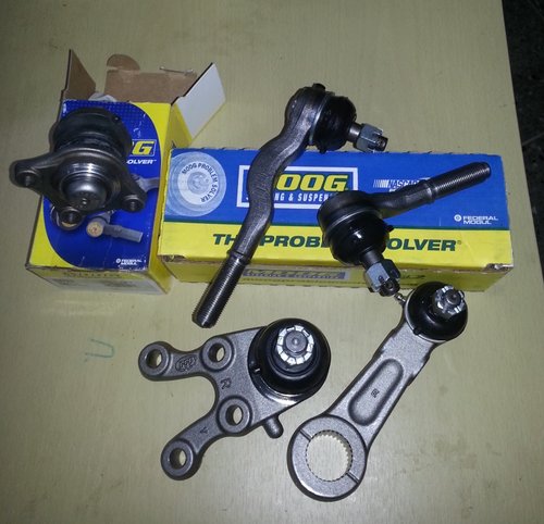

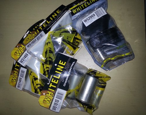

Now update on L200 maintenance Mileage now 227,xxx km. Last oil change at 219K using Royal Purple. Clutch master giving trouble, OEM repair kit on the way. I had bushings here a long time and just got some suspension parts to do overhaul but original suspension holding up still. Clutch is also holding up. See some pics of parts I'm collecting: pitman arm, ball joints, tie rods, bushings
L200 Moog parts
L200 Whiteline Bushing

price on the seals bro?
I bought fake ones and it didnt last long. Learn my lesson.

always be sure to get Genuine oil seals.. these parts places in trinidad dont care about people and always bring in sub standard parts and sell us for high prices!
