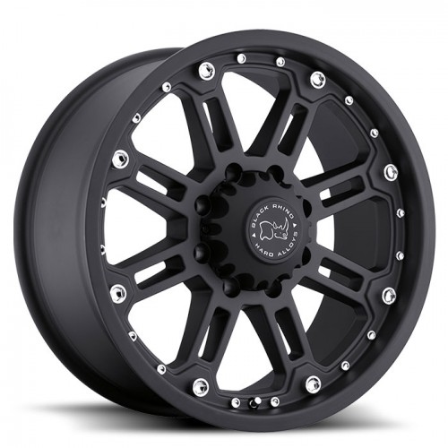

What is the exact size and offset I should look for to ensure no rubbing etc is incurred? Also are spacers advised on this application as I do not want much of a protrusion of the wheels?
The rims that I am interested are these below:
ROCKWELL Off Road Styled Wheels by Black Rhino. The ROCKWELL is a thick open styled multi-spoke off road wheel, which leads to heavy duty bolt accents around the lip. The ROCKWELL is an aggressive off road wheel named after a natural area in the northwest corner of the little Sahara, home to 60,000 acres of sand dunes and trails. The ROCKWELL was designed in two tough finishes; solid Matte Black and Gloss Black with a machined lip to enhance the look of your stock or lifted truck. These off road wheels are available in 17x9”,18x9”,20x9”, with offsets ranging from +12mm, 00mm, -12mm. Each wheel is engineered to carry the heavy loads often associated with Trucks and SUV’s. All wheels are either hub-centric or supplied with centering rings to ensure a smooth vibration free ride. ROCKWELL off road wheels by Black Rhino.

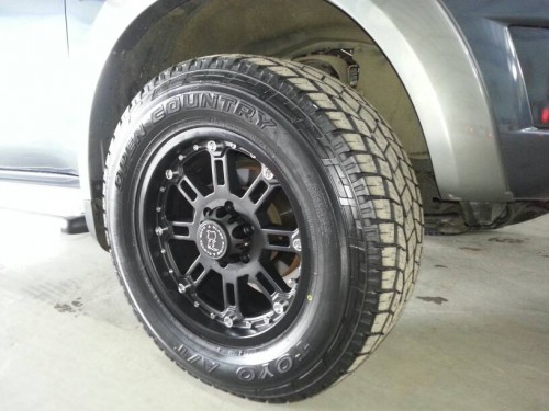

Postby DriFT_KiNG » November 15th, 2013, 4:13 pm
Thanks for the thoughts, comments and ideas guys.
Let me know what you all think.
So far very happy with the buy. A little compromise on the ride as it is a tad bit stiffer and the aggressive AT thread pattern as compared to the stock Dunlop's but still comfortable. The look is amazing and exactly what I was going for. Thinking to get the wider fender flares to complete the look through....

Check it out. ..

DriFT_KiNG wrote:Let me know what you all think.
well since you asked for opnions . . . I do not like
those rims have too much positive offset that pushing the wheel outside the wheel arch
it widens your track and will give better stability, but it takes away from the look of the vehicle
with the rims further outside of the wheel well, it is easier to suffer kerb-damage when parking and when driving in water you will get the fenders dirty with road water
IMHO the sportero looks better with a more negative\lower offset rims with a bigger lip, i.e. wheel bolts close to hub and lip pushing outwards . . . but that is just my opnion and my taste
how much stiffer did the steering get with the 285's over the 265's :?:
DriFT_KiNG wrote: A little compromise on the ride as it is a tad bit stiffer and the aggressive AT thread pattern as compared to the stock Dunlop's but still comfortable.
what pressure you running :?: maybe decrease a bit to get the softer ride :?:
Posts: 16815

Postby VexXx Dogg » November 17th, 2013, 1:52 pm
what offset you went with?
Looks pretty decent and rugged
Think you have it the other way around... -ve means the rim centerline goes more inside sending the rim out of the wheel arch...

Postby droppa » November 18th, 2013, 7:41 am
looks good man, now those are a great purchase, esp the rubbers, they will not dissappoint you, and from the looks of it one would assume u wont be into heavy offraod, just probably a small trail, and you will get a stiffer ride bacaese of the load rating on the tires, they will have a stiffer and tougher side wall, as compared to the stock dunlops..........
