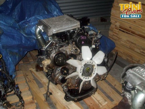

i might be talking chit but why dont you get one of those^ and hook it up with the vigo gearbox, with a adapter.
viewtopic.php?f=55&t=480826

Postby Premera » April 15th, 2013, 9:14 am
no update yet, still waiting for the dust to settle a bit then i will decide which way i will proceed.
So far, it seems nothing in the engine damaged.
The opinion of my main mechanic was change or repair the head and drop in the new injectors and the problem will be solved.he said in his opinion the toyota torbo units and the fuel pump is really durable and he does not think it is damaged.
His suggestion is to change the head and drop in new injectors and this should solve the issue. I am kinda leaning this way because three opinions suggest nothing wrong with the engine.
I am thinking of dropping in the new injectors and seeing if the problem stops ( except for the loss of compression thru the damaged injector port ), run the van for a month or two by which time the new head should reach my doorstep and then do the complete changeover.
Other than that, i am just waiting till i have the funds to do the engine job / change engine ( last resort )
Only two mechanics heard the van idle and they both say no engine damage and they both seemed to believe the head and injectors are the problem.
Not sure if i said this already, james from bamboo opened up the old oil filter and did not find any metal filings stuck to it. he said this is good news and could mean nothing got damaged internally.
