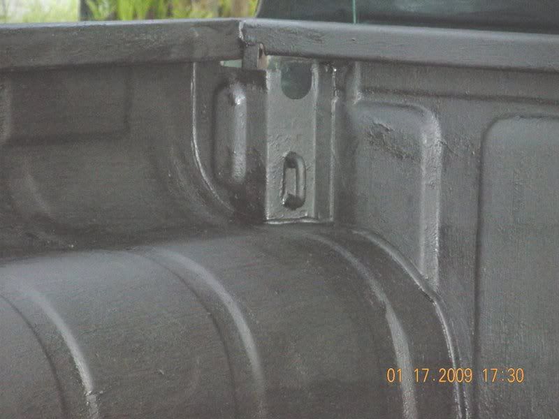

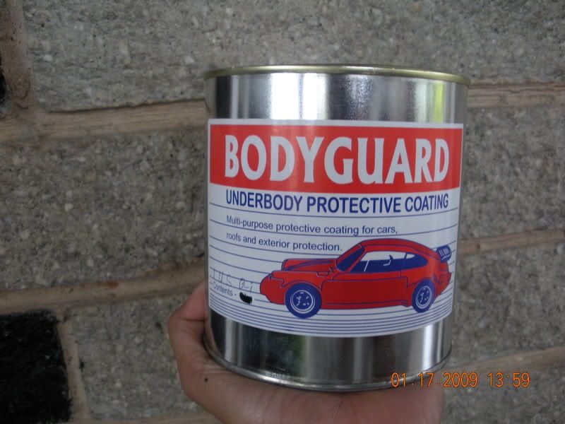

Someone mentioned a kind of tar lining I can line the underside of the van with to further protect it, anyone knows what that is, where sells it or what other options I have?
we all start somewhere
welcome
TD27 N/A makes good power with high reliability
apply generously
caveat - does not stand up to extreme high pressure washing, it will flake out

I have a spray gun and compressor, you could buy some bottles of Gravitek (about $90 each in la Romain) and you could come spray it on yourself. We did the under coating and tray on RottedV's Surflux by me.. The Gravitek gives a real nice consistent finish and about 2 bottles should do the entire tray.

Graviteck is the same as that Bodyguard venum posted there? Which is more durable?
Can I spray it in the tray too? :D
That tray needs attention, went to check a painter today but he drunk in some corner. :roll:
Can I just pass my rust stripper, remove paint, rust and all whatever else is there, prime and apply that Graviteck or Bodyguard?

Postby venum » March 30th, 2013, 5:10 pm
3stagevtec wrote:I have a spray gun and compressor, you could buy some bottles of Gravitek (about $90 each in la Romain) and you could come spray it on yourself. We did the under coating and tray on RottedV's Surflux by me.. The Gravitek gives a real nice consistent finish and about 2 bottles should do the entire tray.
^^^^ Use that
it is better for underbody, cuz the stuff i posted is thick and cannot be sprayed - paint brush for that

I just lending you the tools, you will do the spraying! lol. Rust stripper + gravitek will be enough.
