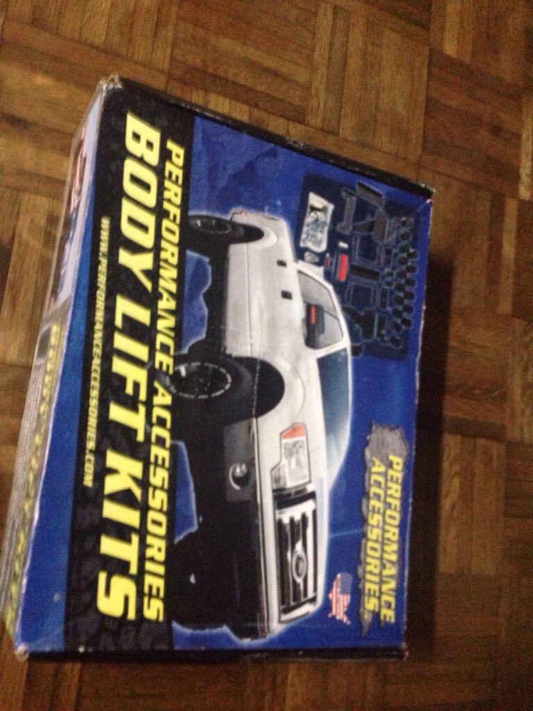

I got this but have no clue on how to install so I'm selling it 3" body lift kit . . $2000 466-2781
