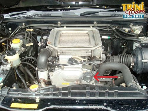

I saw this unit leaking oil. Which is it? Can it be part of the problem, if not the entire problem? Can it be repaired, or do i have to replace? And what other problem will it cause?
Red Arrow Pointing Unit
bigchief3679
Posts: 1041
Joined: March 5th, 2009, 11:02 pm
Re: Hard Start on a Frontier
Postby bigchief3679 » November 23rd, 2012, 4:28 pm
That's the stepper motor for the EGR, in some cases its beneficial to blank off the EGR to avoid gunking of the intake manifold.

bigchief3679 wrote:That's the stepper motor for the EGR, in some cases its beneficial to blank off the EGR to avoid gunking of the intake manifold.
[kublalsingh]and what of nitrogen oxides emissions?[/kublalsingh]
If you find gunk in your intake, just remove it(the intake) and clean it.
bigchief3679
Posts: 1041
Postby bigchief3679 » November 25th, 2012, 7:13 pm
^^^ lolol.....
There are times when cleaning just doesn't solve your problems like intermittent/weird smoke or EGR boost leak.
I've blanked mine over a year now and have only seen improvements, but don't take my word for it, it's been widely discussed on different forums.

IT would seem that many people have oil going into the intake from the egr valve. I recently discovered the same problem on my qd32. The Neal&Massy tech says there's nothing much that can be done about it.(not that we trust their diagnostics all the time)
The EGR though routes noxious oil fumes into the intake to burn them off rather than vent it into the air and you get planass when you go by the doubles man.
Clean your intake, put some consecutive treatment/cleaner additive and run it hard a few days to blow out the cylinders... or break it. Whichever comes first

With respect to blanking the egr. Could someone tell me where exactly to blank it off. you can use the pic in the post. thaks
