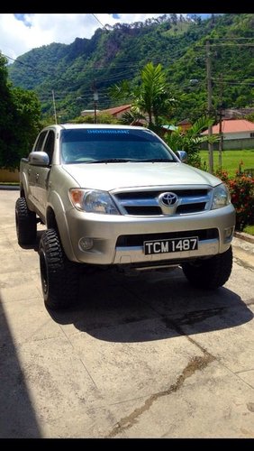

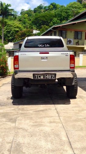

Gas lux is sweet, the 2.7 vvt-i pulls 33" mts nicely, jus as good as diesel, yes there will be power and economy differences, but none the less, strong engine, stood up to a overhead well!
I did this one recently, 3" body, 3" suspension, 33" Bighorns, 10" wide rims!

droppa how much the whole mod cost ,sweet

Price was 18k total for lift, rims, tires and wheel spacers!
