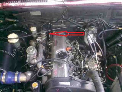

what is the purpose of the cylindrical fitting that is installed to the back of the intake manifold of the 4d56T close to the firewall? it has no lines attached to it, its just threaded into the manifold

Postby cutthroatInt » October 18th, 2011, 1:16 am
see the attached pic..
red arrow depicts fitting spoken about in my previous post.

CD4Accord
Posts: 1609
Joined: December 15th, 2009, 12:20 am
Re: Increased boost on Mitsubishi 4D56
Postby CD4Accord » October 20th, 2011, 12:12 pm
Sorry I took so long to get back but it been real busy recently...
That is essentially an overboost valve.... ie. a failsafe for the turbo.
If the boost gets up to around 17psi I think (not sure about the figure) that will release all the boost for the sake of preserving the engine..

cutthroatInt wrote:I bought boost gauge, oil catch can, boost controller today.
installed oil catch can and boost gauge.
Im gettin 8psi max right now.
what is the stock boost setting on a 4d56T (assuming pajero/L300 engine)
i want to set back my OEM wastegate to where it should be.. before i install the controller and start diggin up.
Accord man, u mentioned that you have a modified catch can to install? what is modified bout it and why? is it something specific for diesel engines?
from tappet cover, i run hose to can.. and i did not run a return hose back to intake... i put a small air breather filter. but alot of air is venting tru that small filter now and making one set ah noise... and sort of fumzing up the place. when the engine shuts off i get about 3-5 sec hissing sound through the filter. so from a previous post in another thread, backpressure seems to be ok on the engine.
i guess i just hav to monitor oil accumulation in the can.
that is illegal to do in foreign . pollution. run it back to intake .. so turbo could pull it in n recycle n create a vacuum
