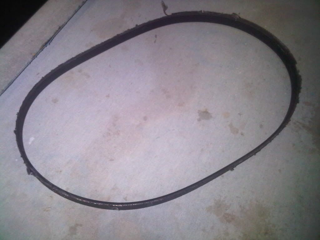

Fellas - was driving to work this morning when I started hearing a knockiong noise from the engine compartment, almost like a flapping noise.
Eased off the throttle a little and the noise stopped, but then I drove the nav easy the rest of the way to work.
When I got in, opened the bonnet and saw this:
Didn't notice any drop in power, no rise in engine temp, no smoke and no loss in performance.Current mileage on the truck - 9100KM.
Gonna drop the truck in N&M tomorrow - hopefully they'll cover the cost of the Fan belt and labour.
Called ROC in bamboo, original nissan fan-belt = $275, while in N&M = $345.

Well i spoke with the service reps in n&m over the phone - fan belts aren't covered by the warranty. I'll have to pay for the belt + labour - prob around $500 or so.
Seems like the belt disintegrating from age - probably the Nav was sitting out on the lot for a while after the manufacture date (no way to confirm this but that's my theory).
My mech. pardna says this can happen with cars that were manufactured and left on a lot outdoors for a while.
I checked the pulley while the engine was running, no shake or vibration, and the belt wasn't jumping out of the grooves. So most likely it's just age related disintegration.
Since it's not covered by warranty, I'll service it myself cuz N&M real sticking. Because of my work schedule (have to be in work for 6am!!) I can't go early morning - plus they won't take lunchtime appointments because by that time they trying to finish off their work-list and go home by 4pm.
The service rep suggested I go to automotive components (since they under n&m too) and got the same story. Best they could do is I could leave the truck overnight and collect it next day - but I'd have to supply the belt myself. Also, the service manager there never heard of this problem of disintegrating belts before.
I think I trust my mechanic pardna more than n&m - he was able to diagnose the problem and even suggested that I check n&m first so they can check the pulleys, etc. Too much bullsh!t to go through just to get an emergency servicing.
Hence I'll stop by ROC tmrw and get the belt replaced.

So this is the belt after changing it out with a new genuine Nissan belt from ROC
And this is what happened to it:
You can see that the internal rubber core is still intact - so technically the belt was still good and could run for a while more. Hence we didn't think it was a manufacturer defect, more of a wear & tear problem.
I suspect N&M would have said the same thing and then charged me an arm & leg just to change it out.
Fan belt by N&M = $365
Fan belt by ROC = $265
From the wear & tear pattern on the edge, looks like something got caught in the pulley and caused the external layer of braided cloth to shred.
Most likely it was a piece of debris, perhaps a stone or stick from the last off-roading stint, that caused the shredding problem with the belt.
And this is the nut from the pulley that was seized & locked onto the bolt. No matter what we tried, couldn't get the damned thing out. Had to remove the entire tensioner arm and pulley to finally get the belt off.
Imagine what N&M would have charged for that now?!?
All-in-all, a simple job that could be done in half an hour. Slacken the bolts, get the Power steering belt off, then the fan belt, slip on the new fan belt, put back the power steering belt, and then retighten the tensioner bolts, tumble the engine and check for tightness then adjust... and that's it! Took a bit longer cuz of the seized nut, but that's nothing.
Total job cost: $265 + $60 = $325.

^ therefore it wouldn't have been a warranty issues since it wasn't a manufacturer defect....
lighthammer
Posts: 4519
Re: Tech Thread - Nissan Frontier, Navara, Pathfinder.
Postby lighthammer » February 18th, 2011, 9:49 am
^ yup.
Hence they would have charged a whole bunch of money simply to change the belt.
