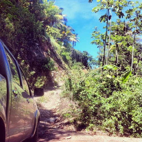

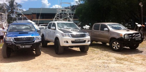

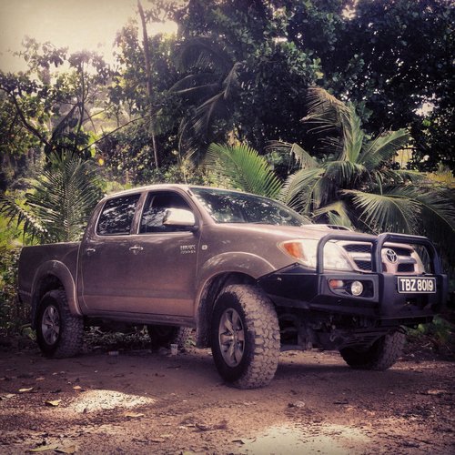

Just some recent pics and vid

Re: 2006 D4D 3.0 4x4 Hilux
Postby rx80 » February 27th, 2013, 9:08 pm
What bumper the blue have installed?
badart
Posts: 560
Joined: May 3rd, 2008, 10:47 pm
Postby badart » February 27th, 2013, 9:44 pm
^ X2 looks OEM
droppa
Posts: 4191
Postby droppa » February 28th, 2013, 8:46 am
white with black bonnet looking mean, on what 18s?
gundelero
Posts: 589
Joined: October 22nd, 2007, 9:51 am
Location: southside
Postby gundelero » February 28th, 2013, 9:48 am
loving that white hilux...sweeeeet
Bezman
Posts: 6635
Postby Bezman » February 28th, 2013, 12:01 pm
white lux is:
3" spacers/lift kit
18" Wheels with 285/60R18 (33") Toyo A/T's
Blue Lux has the new Kit that Jason Comach and them are bringing in for Hilux, cant remember the brand

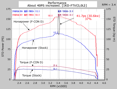

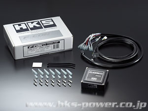

But the real thing I am looking at is the HKS F-Con D. It is a piggy back chip made exclusively for the 1KD-FTV and give up to 40PS (approx 50hp) increase and gobs of torque.
Diesel fuel increasing device for TOYOTA HIACE KDH200 series that is popular base vehicle for customization.
About 40PS will be increased for 1KD-FTV engine (late model) and about 20PS for 2KD-FTV engine. 20 - 30% enhancement from stock engine.
Features
Diesel fuel increasing device [1KD/2KD-FTV engine (HIACE KDH200#)]
1 By increased torque, number of kick down will be decreased and decreased throttle angle may improve fuel consumption.
Installation
F-COND has a connector for harness and 7 wires of the harness will be connected directly to vehicle harness of ECU side. (Modification is required.)
ON <---> OFF switch is available for easy recovery to stock control.
http://www.hks-power.co.jp/en/product/e ... index.html
Ordering it today, going to ask Ryan at United Performance to install as I know he is familiar with the HKS F-Con..
There is also a FULLY programmable F-CON iD for Common Rial Diesel engines.
