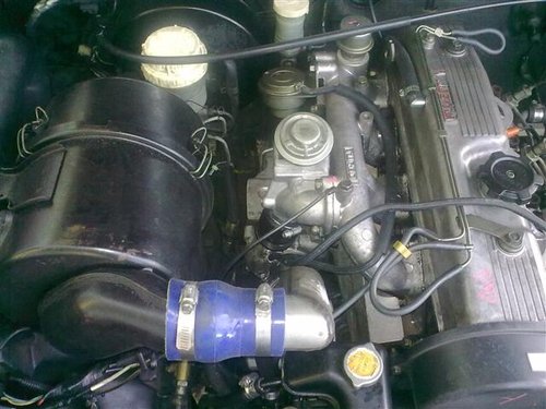

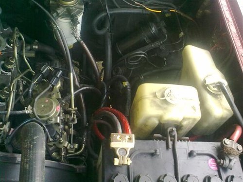

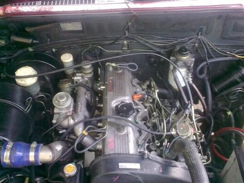

see attached pics bout the air intake piping to turbo i was talkin bout.
Also, can you confirm if this is the same engin in ur pajero?

Injector pump. Extra jack on pump supposed to be for a auto transmission???
See muffler pipe welded to direct air to inlet of turbo
