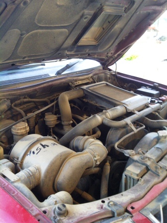

radiator shroud i made!

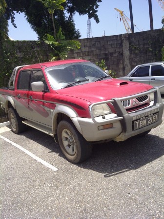

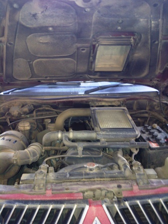

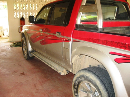

this is my dad's l200 he has it five yrs now and he is in to quarry works!!!!!
all i could say about the l200 is just that it is a very very efficient van !!! it gets the job done!!!!!!
ooo and it works like a charm !!!!
front view !
side view
