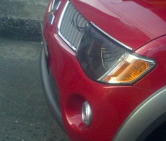

FilterProz
Posts: 187
Joined: March 14th, 2011, 10:25 am
Re: TECH Thread - MITSUBISHI L200, Sportero, Triton.
Postby FilterProz » October 19th, 2012, 9:57 pm
L200 men.... well from the looks of this pic i Have to say L200 ladies and men LOL :lol:
