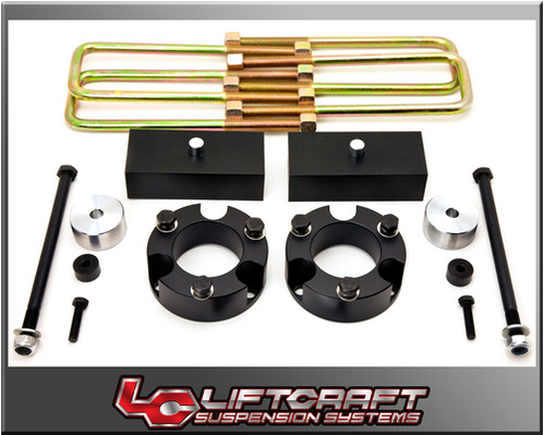

I am about to put a 3" front 1.5" Suspension lift kit in my Hilux.
I've done allot of reading up on the kits and think the spacer kit will work for me. It comes with a diff lowering kit to keep the CV's level and I am getting bump stop spacers to avoid breaking shocks.. Anyone have any experience with them?? I see a few local rangers and hilux's using them, but would like some opinions.
Here is a photo and link to the kit.
http://cgi.ebay.com.au/ws/eBayISAPI.dll ... 877wt_1398

well rangers cant use spacer lifts cuz they have are torsion bars in the front ... but TBH i won't really use a spacer kit if u have any intention on off roading it hard cuz it isn't safe at all and like you mentioned you can easily break shocks/cv's ... rule of thumb is tho for every inch u increase in height u raise the bump stop the same, so in ur case 3 inch bump stop spacers.... should be ok cuz ur getting a diff drop as well
now i never been in one that uses them but i do hear that you keep the comfortable ride which is great! cuz i have the ironman lift and it is harsshhh and sometimes i wish i just went with a body lift instead...or a better suspension lift than ironman

^^ arb shocks and springs give a MUCH better ride than Ironman - had a chance to compare the two and the ARB was so much smoother, and soaked up road bumps and potholes like NOTHING!

yup i know BUT the only thing is that arb is a lot more expensive AND the springs tend to sag quite fast......
i personally wish i went and bought an ULTIMATE suspension kit or even one from the states and adapt to suit .... oh well i have to live with a ride that irritates the sheit out of me until its time to change shocks/springs.....i might even go back to stock :|:|:|:| or maybe not

I've lifted my front 3 1/2" with the shock spacer.
Have the drop diff kit on its way.
Don't like the spacer blocks for the rear assembly...too much work and it slightly changes the angle that the diff meets the diff pumpkin. I'm opting for the extended shackles.
Ride quality hasn't changed after suspension lift...still great.
The only thing is that if you go over a speed-bump with any speed u hear the Upper Control Arm knock the coil spring. So adjusting the lower bump stop is necessary to avoid that.
Also looking to order a pair of extended ball joints for the UCA to return it to factor positioning/aignment (saw them on a blog but havent sourced them as yet).
But all in all with just the 3 1/2'" front suspension lift, & ditching the front mud uards, I'm running on Sumitomo A/T 33x12.5x15 on 15x8 steelies :mrgreen: (no body lift...yet :mrgreen: ). It running sweeeeet!
Loving the subtle roar (road noise) of the tires.
Will upgrade to 15x 10's after body lift and some other mods first

3.5'' is a big lift for spacers tho, do you offroad it much?
