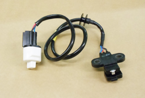

i need some help from the L200 people . i need a crank sensor for a 4d56 turbo . does anyone know where i can buy on locally it looks like this one i found on the net

Postby venum » March 2nd, 2012, 6:44 pm
Diamond Motors
I would buy OEM from Simpsons in Barbados
check Special Auto, Faiz in Marabella

thanks for the names . i will call around to see who has it . any idea on what kinda price this sensor wil go for ??

man you would think i was talking spanish for these people , i called all of them except simpsons and they all said " a what for a what kinda engine " followed by "the 4d56 doesnt carry a crank sensor"
these companys think they know too much.
anyone knows the part number for this ??

well simpsons dont have it and they dont even have a part number for it .. this is the hardest part to find . i will have to keep looking ,if i had a part number i could order it online

hey venum i never found the crank sensor but i repaired the old one so thats over .
