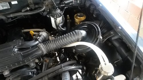

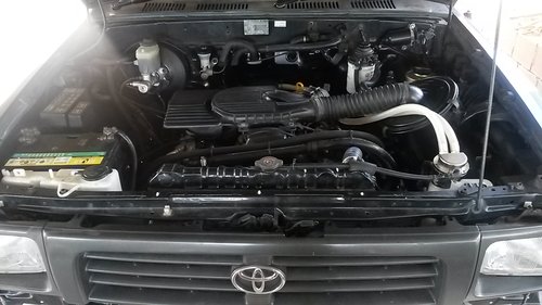

my engine bay....now install the oil catch can. i got through with my build and i dont mind giving someone advice who needs it.

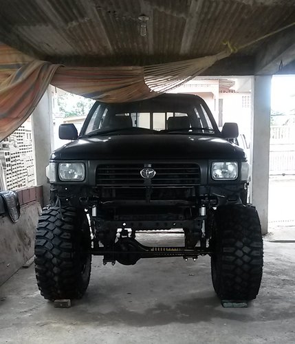

Postby RX7USER » September 19th, 2014, 9:27 am
new tires...no wheel spacers used
Posts: 16828
Re: hilux monster in the making
Postby VexXx Dogg » September 19th, 2014, 9:41 am
WOW!!!!!!!!!
RX7USER
Posts: 53
Joined: May 25th, 2011, 1:34 pm
Postby RX7USER » September 19th, 2014, 10:18 am
even i was shock with the look of the van

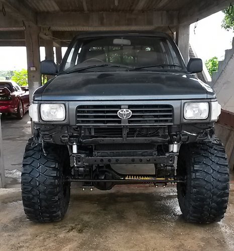

a few other shots

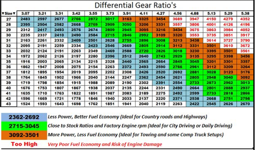

when running bigger tyres make sure you have the correct diff ratio
with my 37'' i am using a 4.88 diff
and i have a spare 4.88 as well
Team Loco
Posts: 5297
Location: Trinidad y Tobago
Postby Team Loco » September 28th, 2014, 6:10 pm
nice chart. will save

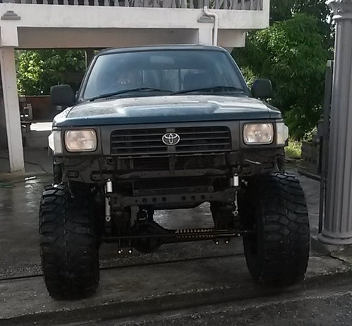

this is my TAT hilux, i would like to raise it and put some 35's on it when money permits

still need to cut hole for the winch and lights
