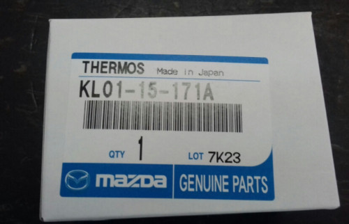

Just got the oem thermostart for under $200

So guys, lets replace the thermostat and not remove it. Engineers designed it for very specific reasons.
Yes, we did.

babygirl wrote:Do not remove the thermostat! Replace it every 60,000km with new oem ($295).
Replacement of the coolant mix according to schedule is more important. Keep an eye on engine temperature. An overheating engine likely has a bad thermostat or blocked radiator caused by age or calcification (calcium precipitation and depost) from the cooling system fluid. Replace the thermostat with a quality, new component that is a direct replacement. OEM parts are not necessary.
What happens when u remove thermostat causes more damage. These wl engines are designed to operate at a specific temp.
