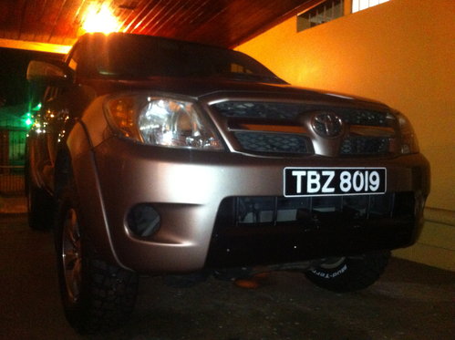

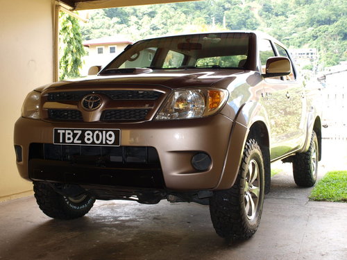

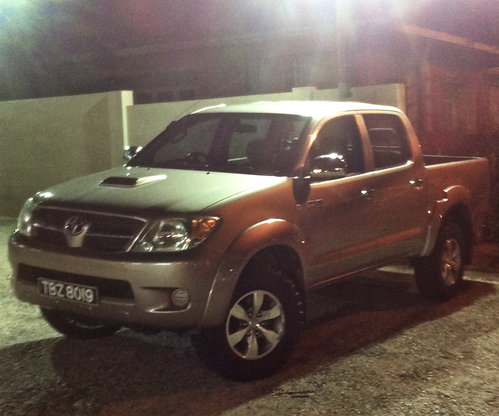

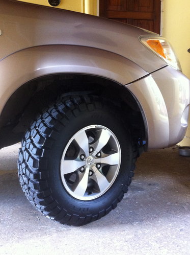

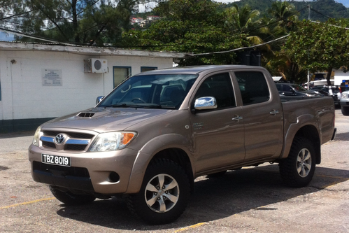

Fitted some BF Goodrich KM2's yesterday, only had 255/70x16 and of course the Hilux swallowed them up :lol: works out to a little taller than 30" and 10" wide... It was between these and 33x12.5x15 KM2's and those looked kinda rediculously wide on the van and have too much sidewall... also running wider than 11.5" tires and most 33" tall tires on the Hilux means cutting the body mount and lots of issues with the upper control arm touching the tires..
I think I am going to go 32" or 33" whenever they get in stock again next year and sell these.. but anyway, I am happy with how it looks for now (till the van is raised and bull bar installed :lol:)
Was bored and decided to paint part of the front bumper and moved the license plate last night when I got home.. next up... bullbar
:lol: and of course as I hit submit on this post, Christian from Milage Mack calls to say they got in some 275/70/16 (32") all terrains and mud tires :lol:

looks good bezman!! .... so u ready for a side b run??
stay on top ur tire pressure.... once u lift u go wanna sell them.... shouldn't be too hard to get them sold cause they're 16 inchers
where u got them? i saw droppa gave u some directions to quikservice.... :D

well what are you going to do wrt the tyres?
what's the average cost for one of these tyres?
keep the pics coming...loving the look.

Yeah I got them at Quick Service... They were ~$1700 a tire and they have a deal where you buy 3 and get one free (finishing this Sat)
I realized these KM2's like gold... 32x11.5x16 (265/70x16) are in order ASAP..
Smeed wrote:looks good bezman!! .... so u ready for a side b run??
I'm gonna be testing them out this weekend at one of our surf spots.. will do a little gopro vid.
Going to go and get my alignment check again and also get the white writing swapped to the outside I think... (tire guy told me to do it yunno) I am also going to paint the stock wheels black I think..

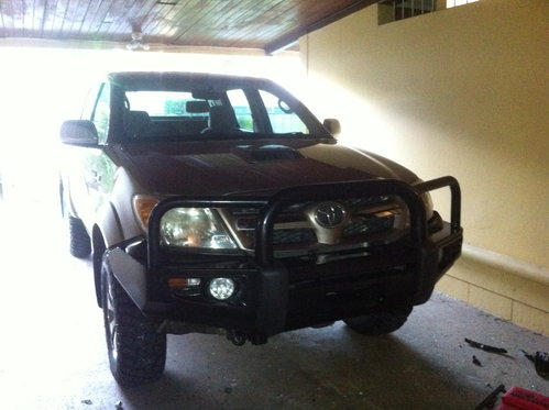

this is the style bumper but all black
Dont think I am putting on the top loop though..

Yes fellas, I real happy with my latest purchase... even though I was leaning towards the tube style bull bar from XROX, the more and more Lux's I looked at I changed my mind...
Anyway, here is the bumper I got from a fellow tuner (thanks Stuarts and his Dad, real cool people)
And just today I was watching the van in TYC carpark and saying I like the front bumper since I painted it :lol:

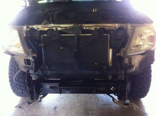

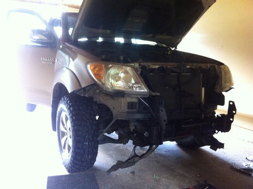

all them live in the west, and the one that doesn't gf does so he there all the time.
WELL...
I did it all by myself in 3 hours :D
the only thing i messed up was I cut the lower grill support too short so need to zip tie down the grill to stop it from rattling :lol: other than that I am exhausted and happy :)

Bez, hows your mpg since the bumper install?
black start
Posts: 7974
Re: 2006 D4D 3.0 4x4 Hilux
Postby black start » December 2nd, 2012, 11:44 pm
That bumper looks so forking mean eh. I saw a similar bumper on a fortuner with a snorkel, I could faint yes.
Bezman
Posts: 6635
Postby Bezman » December 3rd, 2012, 2:02 pm
AllTrac wrote:Bez, hows your mpg since the bumper install?
I monitor this like a hawk. :lol:
Before I would average 600kms a tank (try not to let it go much below 1/4)
I filled up the day I installed (last friday to be exact), BUT i didn't full it as much as I normally would. (would normally full it till it stops the pump, and this time I think i could have fit another $10 or so)
So far today I am on 1/4 tank and on ~420kms.. and if you have a hilux, you'll know this is when the gauge starts to drop fast compared to the rest of the range of the gauge. So i think I may have lost some milage..
BUT
and this is a big factor, remember I also changed tires. And these mud terrain tires are not the best for fuel efficiency.
I would estimate I maybe lost about 50kms a tank? I'm gonna fill up later today and hopefully get some better figures
What I have noticed since the install of both is 2 things, especially the bumper:
1) I am using more clutch/accel pedal for taking off etc, also leaving it in first gear and just cruising at idle (no foot on the accel pedal) in slow traffic now causes more load on the engine and the van vibrates a little compared to being able to crawl at idle speed.
2) People and Maxi's move out the way.. except for the first couple days when I forgot about the bumper, and hesitated and let them cut infront of me etc, now i just charge through and wish them luck :lol:

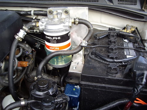

Speaking of gas milage and fuel, this is high in priority on my list as I have already gotten some bad fuel and had to replace the filter, flush tank and drain the fuel system...
http://www.asap-supplies.com/marine/cav ... d-elements
You can get these around, I saw them at one of the marine shops.. great for eye-balling your fuel quality via the clear bowl on the filter... note that this will obviously not replace the stock filter, just run inline before the stock water trap/filter.
