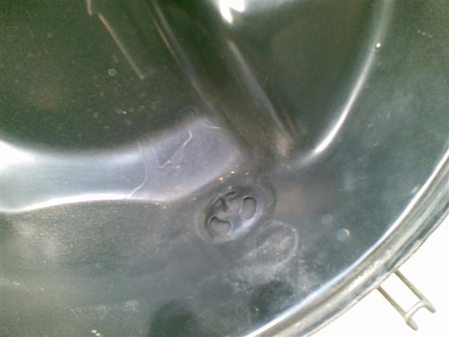

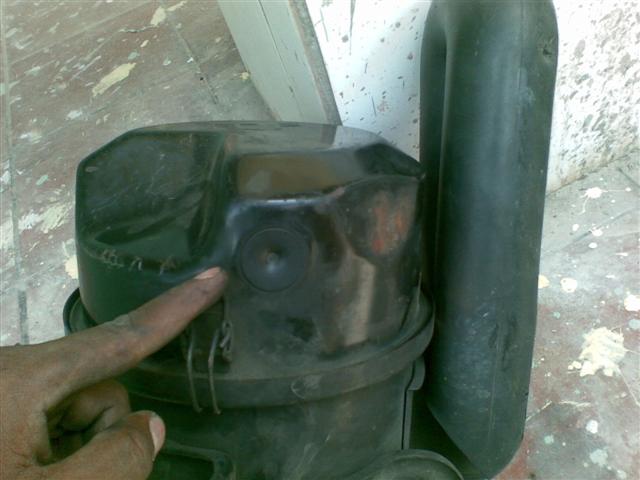

on another note,
i just came back from a "run" up and down the highway.. while driving i began hearing a funny hissing sound. it was coming from the engine bay on the driver side. it was there on idle and when the gas is mashed. it then became a bit louder a little wile after. but no affect on performance. i pulled aside a few times to investiquire and at first i thought it was the air filter housing bolts slack.. as it sounded so. but after checkin it.. it was firmly secured... then i found the source of the noise...
underneath the k14/k34 air filter housing there is a little diaphram type one way valve. when i put my finger over the hole, the noise stopped. when i removed my finger, it was there.
air is gushing out if this hole and this is what is causing the hissing sound.
i never had this noise coming from there before.
what is the purpose of this "valve" and what do you guys think can be causing this air to be rushing out through there?
i"ll pull down the housing in the morning, but just want to get any ideas as to wot it can be.

Postby cutthroatInt » May 15th, 2010, 4:39 pm
i opened up the air filter today, there is no restriction, the air filter element is in good shape and there is the usual amt of oil in the intake manifold.
this lil rubber valve thing still hissing and irritating the sheit outta me..
i can remove the valve all together by ripping off the rubber, but it serves to prevent water from entering... pshtt...
