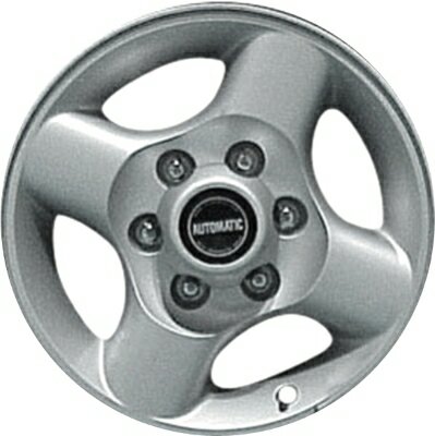

Fellas i'm looking for a complete set of centre caps for the d22 frontier rims like in the pic. Any suggestions?
hindian
