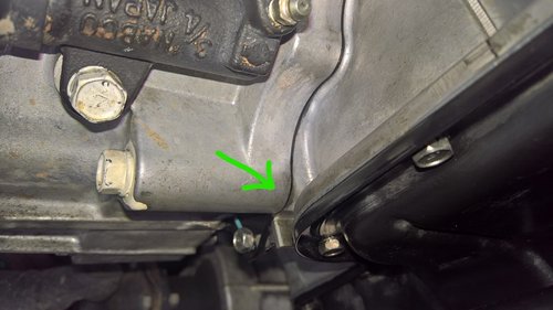

Afternoon Guys, has anyone experienced or know what might cause an engine oil leak from this area (green arrow). Appears to be between the Engine and Trans. Any assistance/advice would be very much appreciated. Its a manual 6 speed btw.
Thanks..

Rear engine seal most likely.

yea could be the engine seal . my advice ..if u replace . install new clutch one time .. cause that is as lot of work n it easier to install with engine out

Supra GT-FOUR wrote:Rear engine seal most likely.
supernedd wrote:yea could be the engine seal . my advice ..if u replace . install new clutch one time .. cause that is as lot of work n it easier to install with engine out
Thanks guys. Is it in anyway unusual that the NAV is doing 53k and the seal is gone or is that within "acceptable"?
Based on the current mileage, should I still consider replacing the clutch?
What might be a rough estimate to have the seal replaced?
Thanks
Thanks
If the van was sitting for a while and you now start back using it...I would say No. If however you were using it constantly and it started leaking...I would say yes. It could also be just overfill in the engine blowing past the seal.
Clutch replacement depends on for hard you run it.

Oh boy, thanks a mil guys, k here goes...
1) The engine was definately overfilled, i would say a little over the second bump in the dipstick, i noticed it when the leak became apparent on the floor, by this time the underside had gotten properly soaked. I went ahead and changed the oil and filter, since it was close to due. Used Valvoline 15-40 Extreme and a genuine filter, filled to the 3/4 mark between the 2 holes and cleaned the underside thorougly, presently monitoring it. Its only been a couple days since the oil change, but from 3 drops on floor, I'm now seeing one either on the floor or just clinging on the underside, when I go for a drive.
2) Since i'm not working these days, the van isn't being used daily as before, I would venture to say 3 times a week on average and mostly short runs, no more that 10mins or so.
3) The van was not purchased from NM, its Thai built and when i referenced the flywheel using the VIN number, i'm getting this number 12310-EB30C, which say's its a Single Mass Flywheel. so i'm not sure.
Not a very good week to say the least!
Guys if possible, what will i be looking at in terms of cost, just a very rough estimate of course, parts & labour and is there someone you guys trust that i can speak to regading the repair?
Thanks again!
