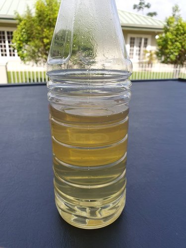

kamakazi wrote:Back to servicing the Tonka truck.
Changed brake pads to Bosch; still bedding them in. Better initial bite than oem so far. Also drained some brake fluid and refilled with ferodo DOT4.
Drained and refilled ATF in pan once; currently do this every 30000kms using Mobil 1.
Changed power steering fluid in reservoir; usually done every oil change and that time is also coming
Cost
Previous total - $850
Bosch brake pads - $370
Mobil 1 ATF (4 quarts) - $280
Castrol dex/merc (1 quart)- $45
Total - $1545

Used a battery water filler (looks like a turkey baster but more suited to what you want to do). Remove fluid from reservoir and refill (I use Castrol Dex/Merc). I do this once every oil change.

Thats not changinflg the fluid, thats refreshing the resevoir.
To flush you need to remove all the fluid from the system by turning the steering left and right, then refilling and bleeding the system.
Takes about 2qts

I mean I never mentioned flushing...I did say I change the fluid in the reservoir every oil change; reducing and diluting the contaminants in the system. Same thing I do with my transmission... It is a bit lazy but I think it better overall than waiting the entire period before changing... If you change at all
(And I have been doing this since the first service)

I start checking for water and sediments
I have a channa bottle in my tray, i does out $1 diesel let it settle and then check it for water and sediments,
If it look good, i does fill up
This is what i getting these days....
