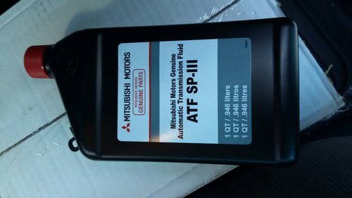

Guys , What transmission oil do you use in the 2.5 Triton?, it's a 2012 Thailand model… the transmission is CVT
Posts: 16816
Re: TECH Thread - MITSUBISHI L200, Sportero, Triton.
Postby VexXx Dogg » January 4th, 2017, 11:32 pm
Honestly, if in doubt with trans fluid - stick with OEM
GixxerMan
Posts: 358
Joined: May 8th, 2014, 1:32 pm
Location: were life has no value..T&T
Postby GixxerMan » January 4th, 2017, 11:56 pm
VexXx Dogg wrote:Honestly, if in doubt with trans fluid - stick with OEM
that's what i'm trying to find out…what fluid the use in the transmission with the "sport mode"….
i know the vehicle did not come from Diamond motors…. because it's a 2012 Triton 2.5 DiD 4x4… the gear shifter goes PRND then + & - "sport mode" as described online….
Posts: 16816
Postby VexXx Dogg » January 5th, 2017, 10:33 am
Didn't get an owner's manual in the glovebox or online. Usually the spec is listed.
Double R Auto in Sando/Couva can probably help. I get a lot of my stuff there. Maruds in marabella has genuine stuff too
GixxerMan
Posts: 358
Re: RE: Re: TECH Thread - MITSUBISHI L200, Sportero, Triton.
Postby GixxerMan » January 5th, 2017, 6:45 pm
VexXx Dogg wrote:Didn't get an owner's manual in the glovebox or online. Usually the spec is listed.
I didn't get the owners manual with the vehicle it was used one I purchased from a company. ..Here are some pics
GixxerMan
Posts: 358
Postby GixxerMan » January 5th, 2017, 6:49 pm
there are no markings on the dipstick to indicate the type of transmission fluid used on this vehicle……. anybody with this model of Triton on here???
Toyopet
Posts: 815
Location: On the road
Postby Toyopet » January 5th, 2017, 8:01 pm
GixxerMan wrote:there are no markings on the dipstick to indicate the type of transmission fluid used on this vehicle……. anybody with this model of Triton on here???
Cuz, you don't have a CVT transmission vehicle. You have CNG and a Variable Geometry turbo and tiptronic transmission which is simply an automatic transmission that allows you change gears as you would in a manual transmission, minus the clutch. Your best fluid will be the kind described on the first page of this thread. Alternatively you can use Castrol, Valvoline or most other ATFs. Hope that helps

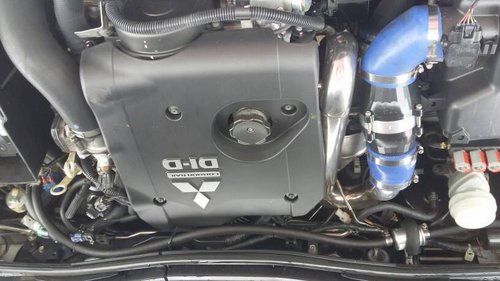

GixxerMan
Posts: 358

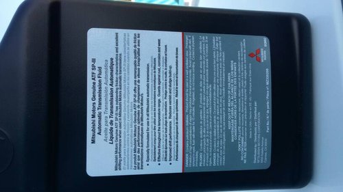

Re: RE: Re: RE: Re: TECH Thread - MITSUBISHI L200, Sportero, Triton.
Postby GixxerMan » January 13th, 2017, 9:30 am
Is this the fluid?
Toyopet
Posts: 815
Re: RE: Re: RE: Re: RE: Re: TECH Thread - MITSUBISHI L200, Sportero, Triton.
Postby Toyopet » January 13th, 2017, 4:10 pm
GixxerMan wrote:
Is this the fluid?
Yup
