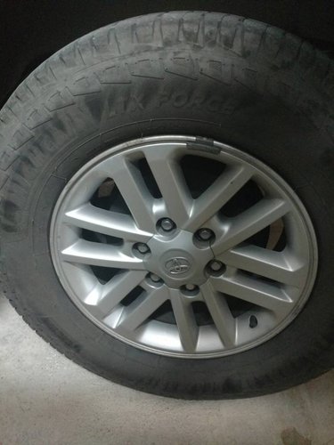

Does anyone know offhand what the offset is on these stock 17" 6 X 139.7 wheels from the 2013 Fortuner/Hilux? Tryna avoid having to remove the wheel to check the inside to then get a meg that it's not there.

carluva
Posts: 1993
Re: Tech Thread - Toyota Hilux...D4D and all older models.
Postby carluva » November 20th, 2018, 8:54 pm
I did but am getting conflicting info. Some sites say its 20mm and some say its 30mm

carluva wrote:I did but am getting conflicting info. Some sites say its 20mm and some say its 30mm
17*7.5JET30
