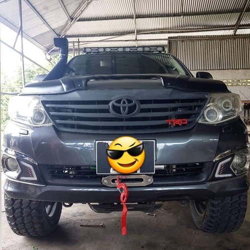

Saw the Fortuner. Some serious lift... One thing I cannot understand, why put all this lift if you running low profile SUV "performance tyres" unless these were swapped out for proper A/T tyres after this pic was taken. The lift looks good, the wheels and tyres, meh.
Posts: 9323
Re: Tech Thread - Toyota Hilux...D4D and all older models.
Postby *KRONIK* » November 9th, 2018, 3:29 pm
carluva wrote:
*KRONIK* wrote:
you can check monster mods inc.om facebook.
They did a bess fortuner recently.

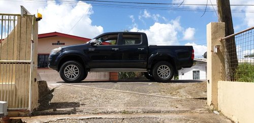

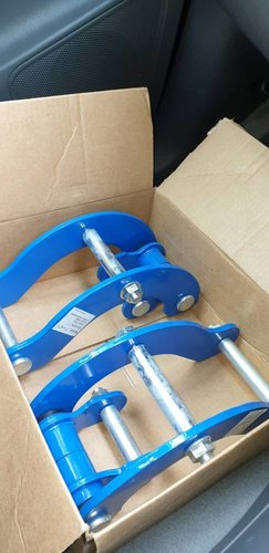

carluva wrote:Btw can you send a before and after pic?
Before
and after
Back end to be lifted still with 2” lift comfort shackles

The stopping distance improved quite a bit
Decide if you getting bumper and winch as that will determine which spring set you get for the lift.
You cant put that kind of load on the stock springs, they will sag.
I'm not a fan of snorkels
Too much butchering of the fender and A-pillar to get them in and they still can cause a lot of water to enter the airbox
Plus, i never forsee any situation where i going in that deep of water.
I have the k&n currently, no noticible difference tbh.
But the fact that it reusable is a big plus.
I still think the OME is the better system as the bilstein is a shock only kit
You need to get your own springs
So you will save on trial and error and i not sure what the combos are for the fortuner.
But talk to westbourne, you gonna need to check them for the OME springs either way.
