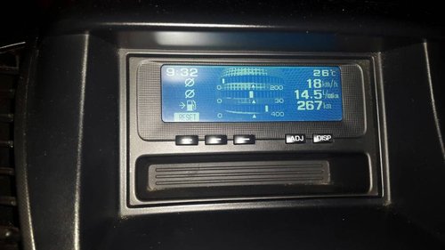

Serviced my van at dm and my fuel economy decreased before it use to be. 10.4L/100km. Can anyone tell me what's wrong. I am also hearing the injector pump more.
I did an injector cleaning, intake manifold and egr. Changed oil and all filters.

Postby 0001 » January 27th, 2016, 11:42 am
tjaiscott wrote:Serviced my van at dm and my fuel economy decreased before it use to be. 10.4L/100km. Can anyone tell me what's wrong. I am also hearing the injector pump more.
It just reset. Doesn't mean that it will stay like that.
That is an average based on your driving style. Give it a while and it will come back down unless you drive hard.
Bro I think you're best calculating your fuel economy manually. Those computers aren't always accurate.
