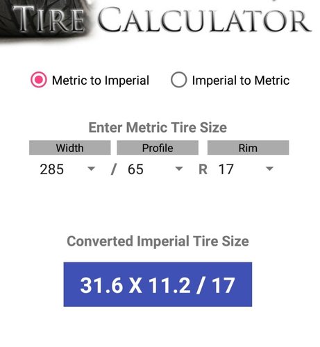

Can 285 65 17 fit without lifting?
Posts: 9323
Re: Tech Thread - Toyota Hilux...D4D and all older models.
Postby *KRONIK* » October 29th, 2018, 5:27 pm
PariaMan wrote:Can 285 65 17 fit without lifting?
Nah bro
I dont think so.
Thats a whole inch difference over stock
It will fit, but you will get some touching at full lock.

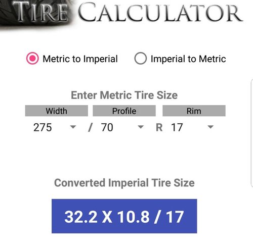

What about 275 70 17
Posts: 9323
Postby *KRONIK* » October 29th, 2018, 6:51 pm
PariaMan wrote:What about 275 70 17
Even worse
Thats even taller
That will need a 3” lift to clear

Or so the problem is the width or the height ?
Looking to buy some maxxis the guy said he had some 285 65 17 and men rush it for the hilux I was wondering maybe it is for the revo ?
Posts: 9323
Postby *KRONIK* » October 29th, 2018, 7:21 pm
Revo and hilux oem wheel size is the same iirc.
Plenty men running spacer lift and willing to chop their van to get fitment.
Sometimes a simple removal of the mudguard helps
Posts: 9323
Postby *KRONIK* » October 29th, 2018, 7:28 pm
PariaMan wrote:Or so the problem is the width or the height ?
Height is the issue here as the overall increased diameter causes the tyre to rub on the inside.
When you lift, you create more clearance ofe the wheel to clear the bumper and fender edges on full lock

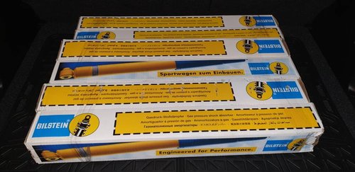

On a side note
ADONI
Posts: 2427
Location: Next Door
Postby ADONI » October 31st, 2018, 11:42 am
*KRONIK* wrote:On a side note
Sweet! Stock replacement or lift?
Posts: 9323
Postby *KRONIK* » October 31st, 2018, 11:48 am
Both!
front is adjustable up to 2.5”
