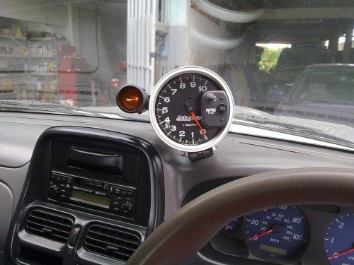

Autometer monster tach installed and new tires coming soon ,the old ones are smooth .not sure how that happend :) pics to come later because my computer has died

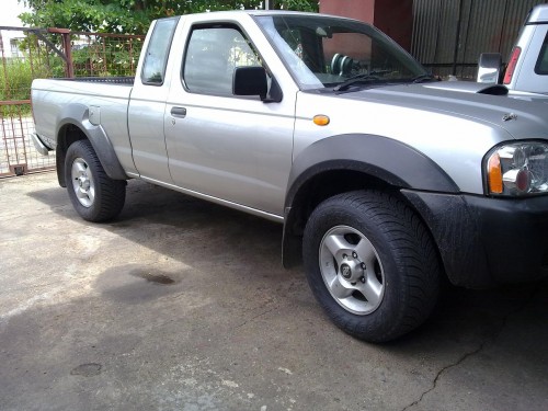

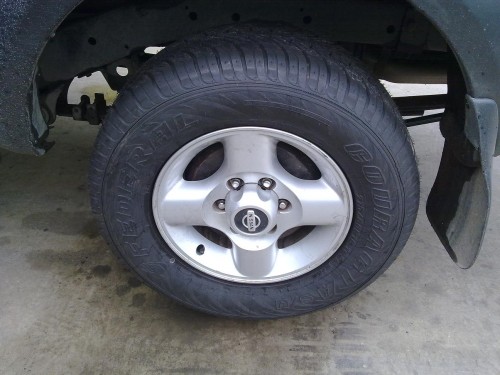

installed 4 new 275/60 R16 its lower and wider than the old 275/70 R16 the van looks so much better and handles better to. Jus needs to drop an inch or two again and it will be jus right. Pics later ,PC still down

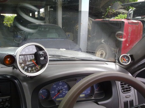

Postby 525isport » April 29th, 2013, 8:53 pm
got a new computer :D
next step is to lower it

I guessing the original diesel tach wasn't compatible with the rb.....
525isport
Posts: 278
Joined: September 23rd, 2011, 6:39 pm
Location: Charlieville Chaguanas
Re: How to Lower a 4X4 frontier??? and put a rb25 in it
Postby 525isport » April 30th, 2013, 7:42 am
no ... but it would have been nice to keep all original gauges for a clean look but everything else works on the original cluster oil light ,charge light,temp gauge,fuel gauge, except the speedometer :roll:

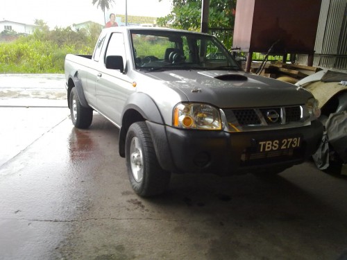

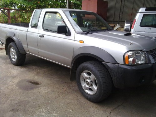

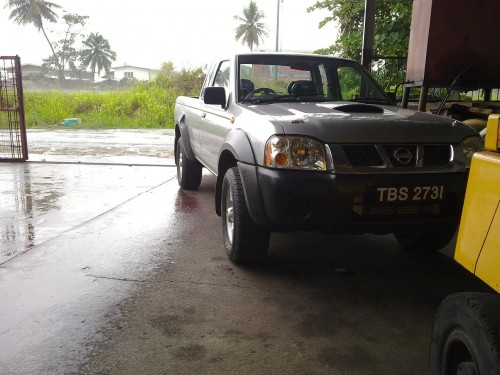

Re: Finally Lowered the 4X4 frontier with rb25 in it
Postby 525isport » April 23rd, 2014, 4:01 pm
well its been a LONG time but the frontier is now lowered ,not by much but it has transformed the ride ,handling and looks too..
i re indexed the torsion bars along with new upper control arm bushings and overhauled the rear brakes with new cylinders and shoes ( the old pistons were rusted in the cylinders so no rear brakes :shock: )
you probably cant see the difference in the pics but its at least 1 1/2 " lower all around and looks soo much better
