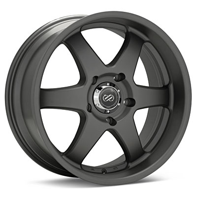

TG7788 wrote:Thinking about putting some 20x9.5 wheels on my auto 4x4. First of all, can this rim handle a 275 tire and can I safely use a size of 275/60/20 without damaging the suspension, engine, transmission, etc? I don't want any low profile tires. Or should I go with a smaller 18" to use that width and profile tire.
once your offset is correct then you should be ok. What you'll need is a lower offset to get the calipers to clear, and on a 9.5 width rim, a backspacing of maybe less than 5 should be ok.
I believe the lowest offset you can go is about +18, after that your tires will stick out of the fenders if you using anything wider than 265's.
My advice is to use the wheel fitment tools on http://www.tirerack.com and http://www.discounttiredirect.com to see what is the necessary offset/backspacing for that spec of rim you wanna use, and make sure whatever you buy will fit.
Also don't forget the PCD or bolt patter on the navara is different, it's 6x114.3 / 6x4.5 (what we trini's like to call "close-hole") rather than 6x139.7 which is found on ALL OTHER 4X4 TRUCKS (stoopid nissan and their communist ways).
Also, the rule of thumb is to go up about 1-2 jumps in size if you wanna upgrade your wheel sizes.
20" will definitely work and it's up to you if you wanna bolt them on, but be aware that the navara is a heavy truck (midsize) and won't take kindly to hard bumps on the road.
Enjoy!!

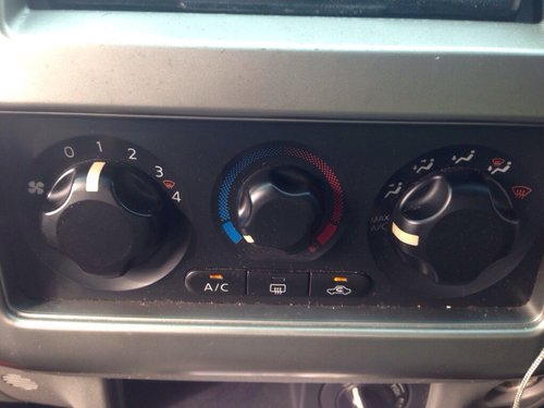

Anyone change the fan blower motor resistor in their D40? The ac works on all the setting numbers 1,3 and 4 but when placed on 2 the ac light goes out,where can I buy the part locally besides at the firm because I am seeing it on amazon for about 50 $ US
jhonnieblue
Posts: 1781
Re: Tech Thread - Nissan Frontier, Navara, Pathfinder.
Postby jhonnieblue » April 14th, 2014, 7:05 pm
Nope...try eBay tho
Enjoy!!
Thanks lighthammer.
The rims I had in mind were a set of Enkei ST6 but they don't come in the 20" for the Navara's bolt pattern. I am considering going with the 18" or will look around for another set.
lighthammer
Posts: 4519
Postby lighthammer » April 16th, 2014, 10:05 am
^^ nice wheel, was thinking of changing my own previously but decided to stay with the current set.
Be aware that getting 18" tires locally is difficult though... you'll sooner get in 20" sizes.. but they can be found if you look hard enough.
