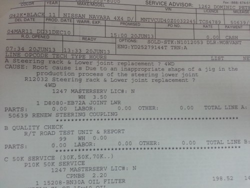

Just a heads up for 4x4 owners, I did my 50,000KM service at Neal and Massy south branch recently. Apparently some 4x4s (dependant on year manufactured) need to have a part replaced on the steering rack that eventually causes noise. The part was replaced under warranty and no charge to me. Here is a picture of what it said on my bill. I advise anyone who has not had this part replaced to check with Massy to confirm if it is required on your vehicle or not. It automatically came up on the form they fill out when you drop in the vehicle for service. I did not complain about any steering noise. Was actually a little surprised I did not have to experience a problem first and complain to them in order for it to be fixed. Hope they keep this kind of service up.
Aaron 2NR
Posts: 6476
Re: Tech Thread - Nissan Frontier, Navara, Pathfinder.
Postby Aaron 2NR » June 24th, 2013, 4:13 pm
instead of doing a recall they change it during a major service. had my clutch, flywheel and pp plate changed under warranty because of a design flaw.
