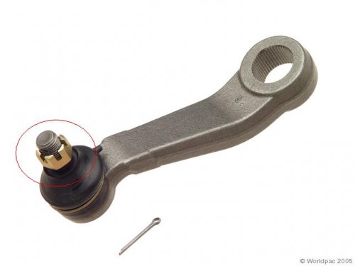

aye fellas i need alyuh help , i need to get the pitman arm for my van , the 555 brand will not work cause the stem is smaller than the original ,apparently there is a thin stem and thick one. i called faiz and they dont have in stock nor does the ford dealer ship. can anyone assist me?

trinibajan34 wrote:aye fellas i need alyuh help , i need to get the pitman arm for my van , the 555 brand will not work cause the stem is smaller than the original ,apparently there is a thin stem and thick one. i called faiz and they dont have in stock nor does the ford dealer ship. can anyone assist me?

Postby civic minded » May 27th, 2013, 9:17 pm
^^ have you tried Jerry's or Chase Village auto supplies? i got my pitman arm for the 2006 ranger at Jerry's
Also try ROC in the bamboo - they stock parts for rangers
