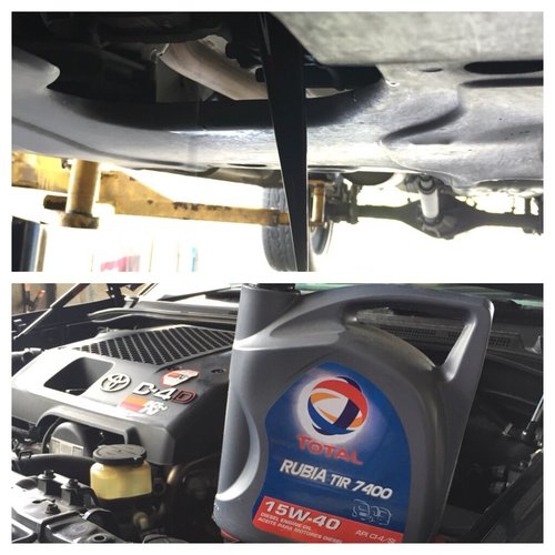

Postby Aaron 2NR » April 24th, 2015, 12:18 pm
Decided to try total oil in the hilux
Big Z
Posts: 2505
Joined: August 11th, 2004, 9:58 pm
Location: 734-7669 Amsoil, Chevron, Redline, Fuel Injector Cleaning
Re: Tech Thread - Toyota Hilux...D4D and all older models.
Postby Big Z » April 24th, 2015, 5:41 pm
I'm surprised that you went with a conventional oil with an unknown additive pack.
Aaron 2NR
Posts: 6476
Postby Aaron 2NR » April 24th, 2015, 6:06 pm
Rubia TIR 7400 SYN NA SAE 15W40 is a premium synthetic CJ-4/SM blend developed for 2007 and newer low-emission diesel engines with after-treatment systems
if I'm not pleased with it in the next couple kms i will switch back to liqui moly. my hilux doesnt get a lot of work, mainly city runs so when i get up to about 500km i will let y'all know.
wanna try the kendall next...
my van is doing about 67000km

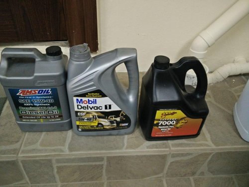

Postby mitch1980 » April 25th, 2015, 10:42 am
110,000km on my 2011 hilux.
i have been using Amsoil in my 2011 Hilux for 2 straight years no issues average 700-720km per fill up
used Mobile 1 Delvac in November 2014 as Amsoil was scarce to get at the time i was looking..not bad
however in my March 2015 service i used Schaffer 2000km in Schaffer thus far
quieter engine
fuel efficiency still the same 10.8/l
the mechanic wants me to bring a sample of all the oil i used he has a machine to test the properties of them will do so next service...3months time he is Schaffer distributor.
Aaron will try the Liquid molly later this year.
