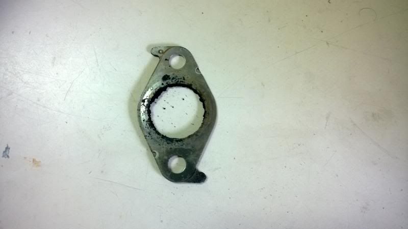

I wouldn't get that letter . . . damn
mine still on their records as the first owner . . . and I already replaced mine earlier this year . . . steupes
ANYWAYS . . . I blanked my EGR today by Dr.B
made the flange out of roofing material
Remove the EGR pipe where it exits the EGR cooling chamber to the EGR valve
Remove the gasket
Overlay gasket on flange material and trace pattern for cutout
Cut out the pattern
Insert cut-out between layers of gasket
Replace gasket and EGR piping
total time start to end ~ 20 min
Y'all know the doctor number, call him and make your appointments
Posts: 16828
Re: TECH Thread - MITSUBISHI L200, Sportero, Triton.
Postby VexXx Dogg » November 23rd, 2013, 9:48 pm
implications of the EGR block?
venum
3NE2NR Diesel Boyz
Posts: 6001
Location: San Fernando
Postby venum » November 25th, 2013, 6:35 pm
