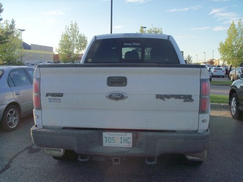

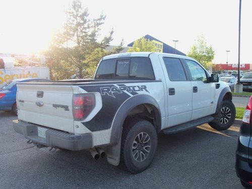

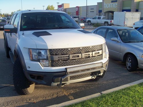

this is for the Ford Fans, saw it and had to take pics and post it. This is in Edmonton Canada south common.
standing up by the bad ass Ford Raptor
the front with led off road lights
yes it dutty
Raptor
Ford dealership behind the hotel where im staying
