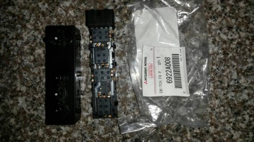

Re: TECH Thread - MITSUBISHI L200, Sportero, Triton.
Postby Val » October 5th, 2013, 11:54 am
The Mobil gl5 made a big difference, smoother gear change no more metal clunk of the diff gear backlash. Also taking corners better with more predictable oversteer.
Need some help though, couple issues have arisen:
1. Hesitation on acceleration (like surging or oscillating rpm instead of smooth rpm increase). Most pronounced in 2nd gear but happens in all. Never cleaned my injectors but using the amsoil fuel cleaner. - solved replaced injectors
2. The driver seat backrest electronic adjuster switch not functioning but I can feel the motor and it is very hot. It's stuck in the upright position. - solved replaced seat switch
3. Belt squeal from ac belt I think. Not sure how to tension as space is very tight. - solved replaced alternator bearing
SOLVED

Posts: 2469
Postby Val » October 14th, 2013, 6:15 pm
For those who might benefit, sorted out all problems.
Changed 4 injectors denso oem, changed front driver seat adjuster switch, cleaned egr & intake manifold & fuel rail. Also replaced alternator bearing.
